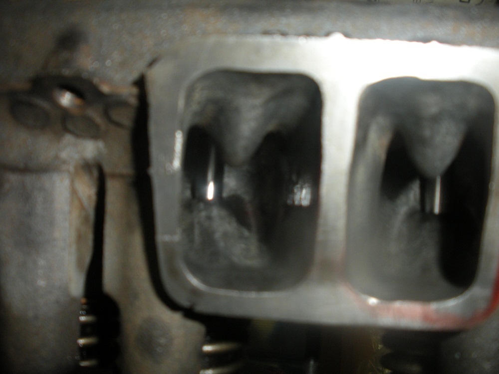

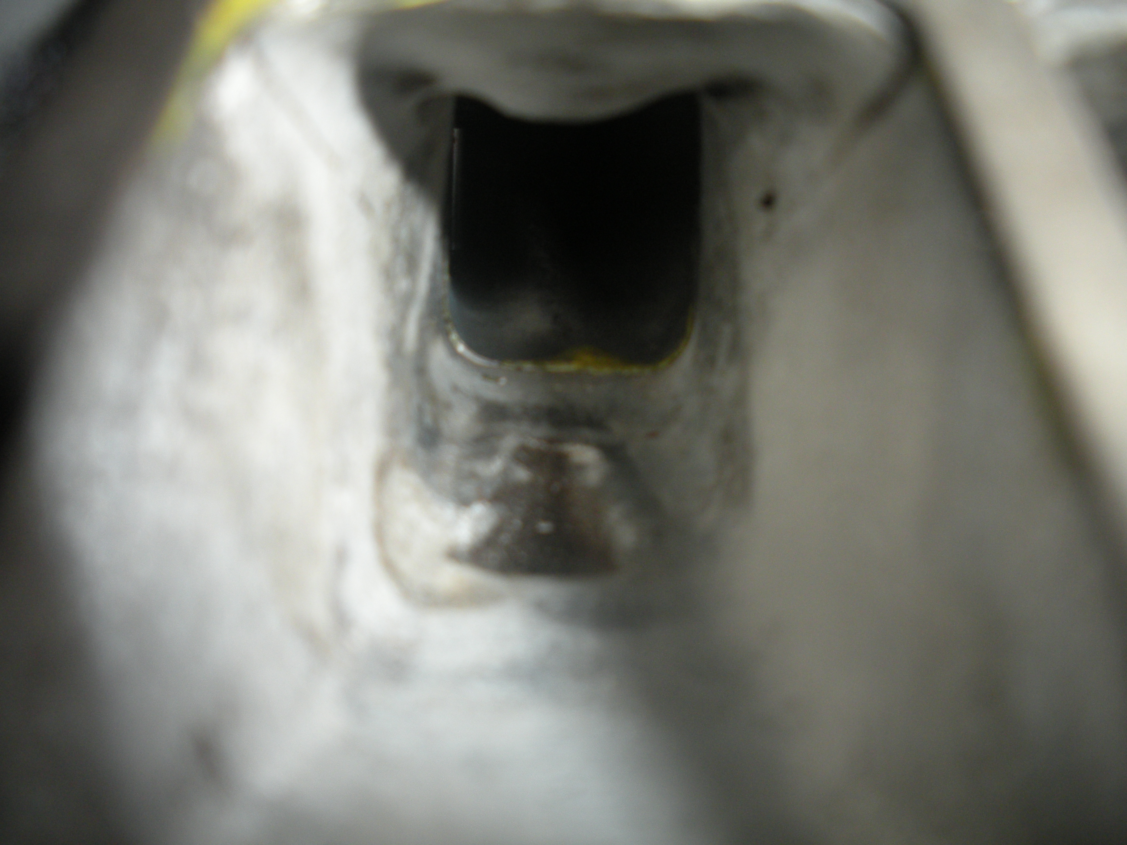

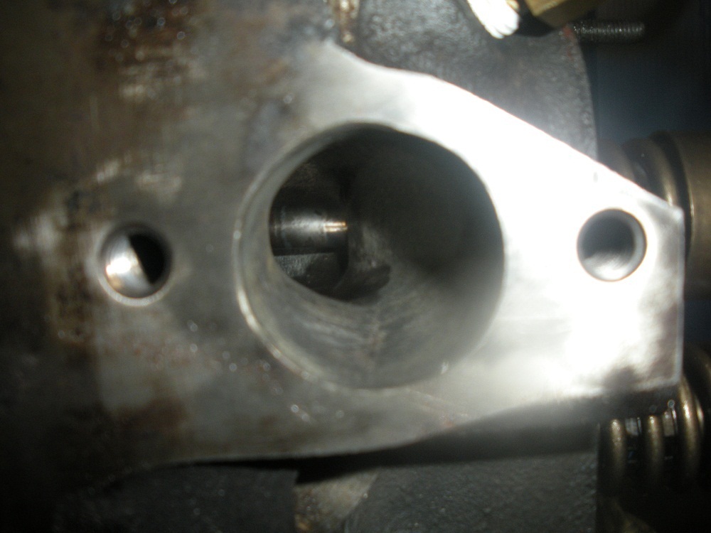

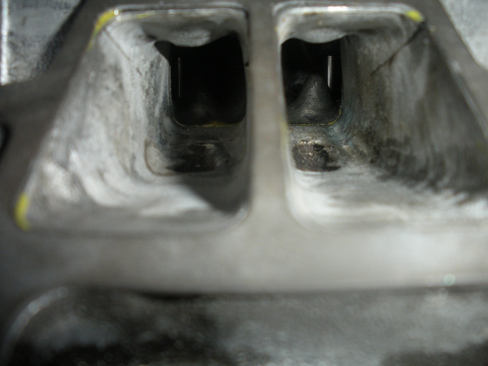

        polishing can be a waste of time if ur on the street. i recintly went through my 2,8 top end gasket matched everything and mild port just to help flow and transition and yes i did go through the heads as well and yes be very carefull of the diverter the little pointy thingy in the intake port of the head i cleaned mine up a little smoothing and transition but kept it just remember think like a air molicule they are dumb and dont know how to drive lol Click image for larger version

          Do an 80 grit finish on everything. Are you doing the heads or just intake manifold?
