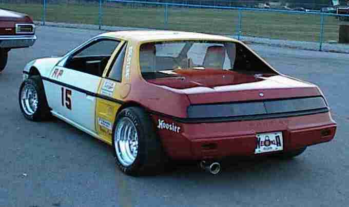

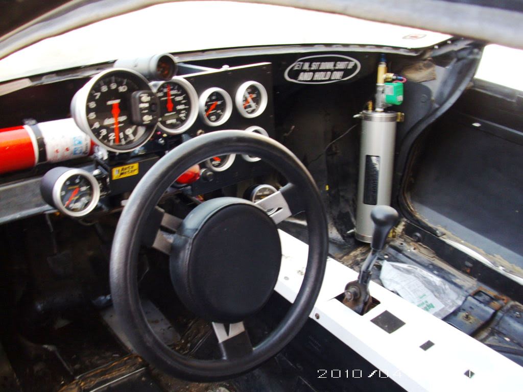

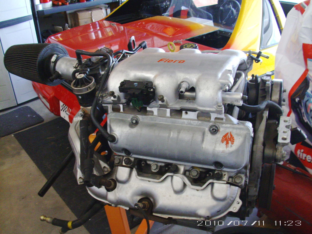

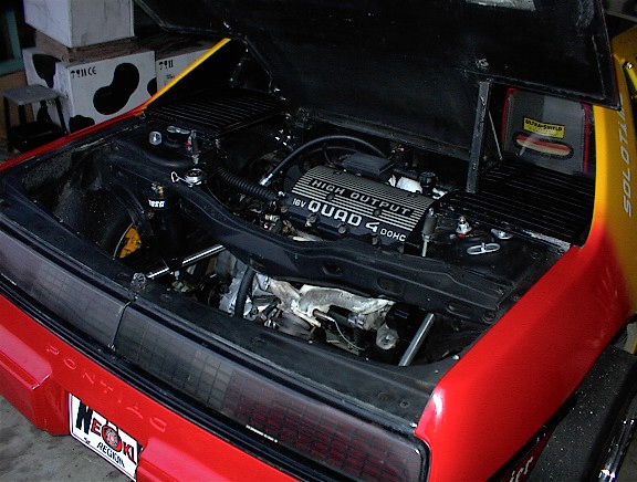

                • #23
                  A picture of the racecar with the Quad 4 (taken in 1997) and of the "dash" of the Pegasus Motorsports car. The third photo is of the "2800" engine, still in progress. I will send photos of the entire car as soon as I get it back from the shop that is installing and welding the cage. The third photo is of the Caddy powered daily driver at a local SCCA ax last February, just for grins.
                  The "2800" engine hasn't been installed yet. It started as a stock 2001 engine with bad rods and crank (and badly sludged up with signs of overheating). We rebuilt it using a reground 89 2.8 (DIS aluminum head) cam kit and rods, This photo was taken before the DIS module with Accel Super Coils and the front end from a Fiero (double timing chain with only the alternator and short shaft water pump and pulleys) were installed. We are currently swapping computers and wiring harnesses before installing this engine. After I get the "real" race motor built up with the wild cam, and using the WOT heads and intake as discussed earlier it will be an easy one day swap to replace this motor with the "real" race engine . . .
