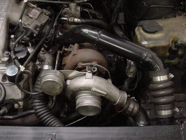

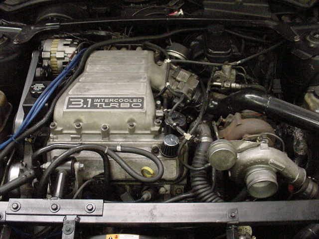

        Been there, done that, but I'm not sure if it's exactly what you are talking about doing. It's in a 91 Sunbird 5-speed. With turbo. I happen to have it back for some work and more tuning, so I'll take some pics and post tonight. Here's what I did: 2000-model 3400 from a van. Heads and manifolds off the 3.1 Turbo. Modified the crossover with a T3 flange. Straight T3, .63a/r turbine hsg. Custom downpipe. It's been two years, but here's what I remember about the swap: I used the stock 3400 roller lifters and cam and the stock 3100 rocker arms. IIRC, I had to use the stock 3.1 pushrods, but only after taking the roller lifters apart and bleeding them all the way down so they would lash properly. I tried to fit it all together, and it looked like the pushrods were going to be too short. The lifters, after 140K miles, didn;t want to pump up. I soaked them all in kerosene over night, disassembled them, cleaned them with a pipe cleaner, and reassembled them. They came in about .010-.015" preload. Alot less than the factory uses, but just like I like them. Oh, I switched out the wire retainers for steel snap-rings due to the tight lash. I do remember changing the timing cover, tho I don;t remember why. I think it was partially so I could retain the r.s. dogbone-a/c bracketry. It looks totally stock "3.1 Intercooled Turbo". The engine made more on 4psi boost after the swap than it did on 7psi boost before the swap. it was not a bad swap, alot of people ridiculed me for it. But it is a torque monster. The turbo spools about 1000rpm earlier than it did before. It made 250whp on 10psi with the (relatively) small turbo and a tiny intercooler. I now have a bigger Starion fmic on it. I will be taking it to the dyno tomorrow.

                I hate to butt in, you seem to have your mind set on this, but for all the time, effort, and expense, you can bolt on a T3 and make way more power than any gains you think you will see by swapping on the 3100/3400 heads and intake. Just cut off the T25 flange and weld on a T3 flange. You are planning to build a custom downpipe anyway, right? So build it for the T3. The T25 is only capable of 20psi and 260hp. You will probably see the 260hp long before you see 20psi on a 3.1L. And the more boost you push, the lower the peak HP rpm will be. I saw a TGP running 15psi on the stock turbo and it peaked at 3600rpm! That turbo was used for one reason, to keep warranty claims low. It would be nearly impossible for the non-driver owner to blow it up. And it made the car feel fast as hell even tho it was slow as christmas.
                On the other hand, the 3.1 I built with the T3 in the Sunbird made 200whp at 5500rpm on 7psi and that was with a tiny FMIC. It would take 15psi with a T25 to do that and it would be come in no higher than 4000rpm.
                The 3400 and it's roller cam profile wake an awesome combo under the old 3.1 heads and manifolds. The best thing is the stock turbo "kit" bolts right on. The smaller ports are not an issue, remember, the turbo creates air flow!
                Or instead of any engine mods, why don't you just raise the boost one or two psi. It will do what you are trying in terms of power, and you can do it without getting dirty even!

                  The best part is it looks stock. Most people would never know any different.
