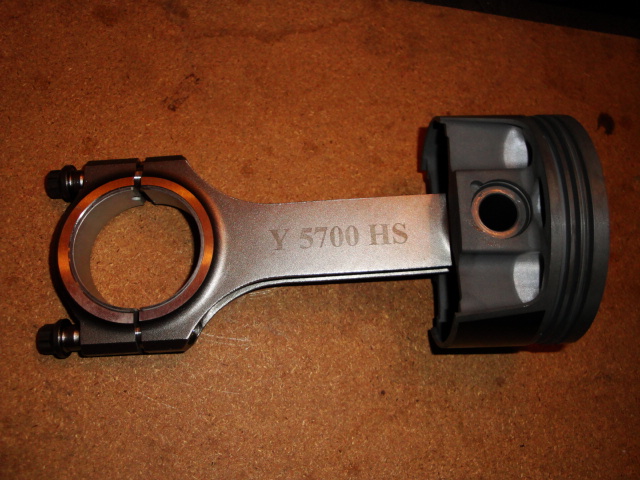

    The crankshaft has been offset ground to 3.430" stroke and the rods should be ready from the narrowing process tomorrow.
    The end result should be about an 11.5:1 compression engine after the stroke increase and 9cc dish Forged LS1 pistons provided I don't have to notch them for valve clearance. I've run the engine under some pretty "mean" conditions upto 8psi on midgrade fuel and the most I got out of it was about 1 degree worth of knock retard and I'm sure that's the result of the poor tune in addition to a spark table with a little more advance than the stock Turbo Grand Prix main spark table. With the HD aluminum radiator, post turbo water/meth, oil cooler and possible addition of preturbo water/meth injection, I believe double digit boost will not be a problem at all. The goal is high output, high fuel economy and proof over speculation as to what is practical boosted compression in modern motors.

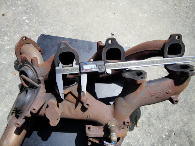

    Not to provoke debate, but I feel the stock exhaust system the engine came with is perfect for a single turbo in the Fiero. I only wish I had been thinking on a "KISS" level when I first started the project. The ports in the manifolds are very well contoured and directed towards the exit. The crossover is stainless with a bellows joint and is just shy of 2.00" in diameter. I have the heat shields also but I'm going to wrap it anyway to make sure the heat is well contained. I may put the wastegate over the O2 sensor bung, or possibly on the molded area on the rear manifold at the merge point of the front bank. I doubt very seriously that any header outfit I could build, including the one I currently have on the car will out flow the stock system design by enough to warrant going through the trouble of building it. Unfortunately I blew $100 on some mandrel bends and a V-clamp before I remembered that I still had the O.E. exhaust manifolds that came with the engine. If the shipping fee had been in my range it would have been ~$155 as I would have purchased another pair of exh flanges. I'll cut off the flange and weld the T4 flange on to maximize the outlet area going into the turbo flange.

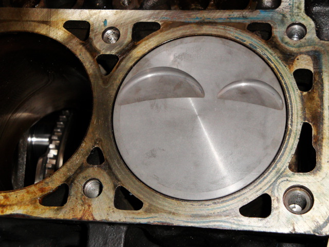

                  So far everything fits in place. The piston sits just below the deck or near even with it. I didn't install the rod cap because they have alignment sleeves that aren't very cooperative with cap removal. When it's all completed including the flywheel change the entire rotating assembly will be upwards of 10 lbs lighter. The G-tech analysis will have to wait as the second cheap gear shift cable failed today just after install of the seized selector replacement so I will not get to test drive the car before leaving.

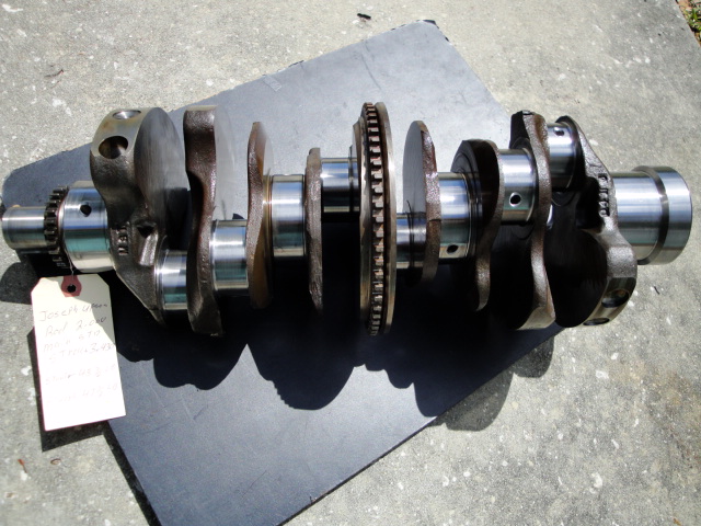

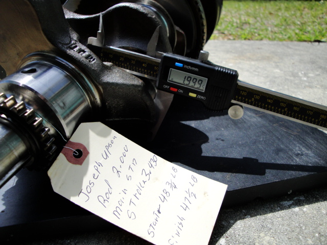

                      Finally got around to checking valve to piston clearance today only to find at the end it's worthless as the machinist did not do what I explained I wanted done to the crank.
                      He did an excellent job of radiusing the crank in place of the stock undercut (clue #1), unfortunately that radius creeped into the bearing surface which pinched the wider chevy 2.00" bearing. The 3400 bearing works but is not quite centered. No problem, there maybe chevy race options that are narrower or I can have a custom set made.
                      Back to the radius. If you explain that you want a 2.25" journal, offset to 2.00" and that you have ~.125" to work with and that you want the metal cut from the bottom of the pin so that the stroke increases outward by .125 minus cleanup, and don't cut the top of the pin except to clean it up, I would hope one would understand that the top of the pin is not to be cut except minutely where necessary. This means that you can't possibly radius the entire diameter of the under cut stress area unless you weld first or cut considerably below the desired stroke.
                      I explained all the above after saying I wanted it stroked to 3.43 so he would understand I didn't mean .012"/2= .006" above and below to get 3.43, but a full
                      .125" shift outward. I explained stock rods are 5.827 and showed him the 5.7 rod they were being replaced with so he could make a mental comparison.
                      Now I have to wait until Monday to contact him to see if we can't work something out. Now I know no matter how competent the machinist is, from now on I'll be providing connect the dot easy drawings and ABC explanations.
                      As it stands the piston bolted down sits .096 below the deck at TDC plus the head gaskets ~.064 so it's a safe bet he didn't weld anything. I'll find out what went down when I get in touch with him.
                      Let this be a lesson to those having machine work performed for this engine involving an offset grind. Draw it on paper with big numbers and no room for excuses.

                        Sounds like it was turned straight down.
                        EDIT: Did you check the oil clearance between the bearing and crank?Tthe pin should be 1.98-1.99".
                          1.995 by my measurement. After looking back I know I was clear about what I wanted, I physically pointed at the pin and said "don't take anything off the top of the pin, remove the metal from the bottom and cut the top to clean up the circle only if needed. I want the pin to move in this direction (outward) by .125". He gave no inkling that he didn't understand what I wanted and I left feeling he understood fully. I add the .125 to 3.31 to get 3.43, but he must have ignored what should have been a conflict to him based on my request that he not touch the top of the pin and that it needs to move outward by .125. You can't have both with his thinking yet he said nothing to the contrary. I even showed him my rods and told him there is a .127" difference in length, 2nd grade math is simple enough to make the needed correction in the crank obvious.
                          He's offering a $50 discount to regrind another but I'm going to write him a nice constructive letter reviewing the conversation that he showed he understood. Otherwise I'll deal with someone else. It's partly my fault because had I approached the situation as if he were incompetent he would have had a drawing with measurements and an error based on that is not a mistake, it's defiance. I listen to my customers, and when they make a request that doesn't make sense or there is a conflict, I let them know so that when they put their money down, I know what they want and they know what they're getting.
                          I'll put the crank up for sale, he did a wonderful job radiusing the pins which is stronger than the stock undercut. The one up side is that I'll have to enter a larger stroke value in Dyno which will estimate higher output.

                              At least the second machine shop got the rods right. I'm gonna contact him and let him know how much I appreciate him calling and telling me after his initial commitment that he would need to direct me to a machinest he knew because he didn't feel his equipment or his experience were enough to do the job right after seeing that the rods were offset and center would need to be located in order to make sure the right amount was removed from each side of the big end. That only cost me $30 more than the initial quote, a small price to pay for having it done right the first time compared to what the crank fiasco is going to cost me to correct.
