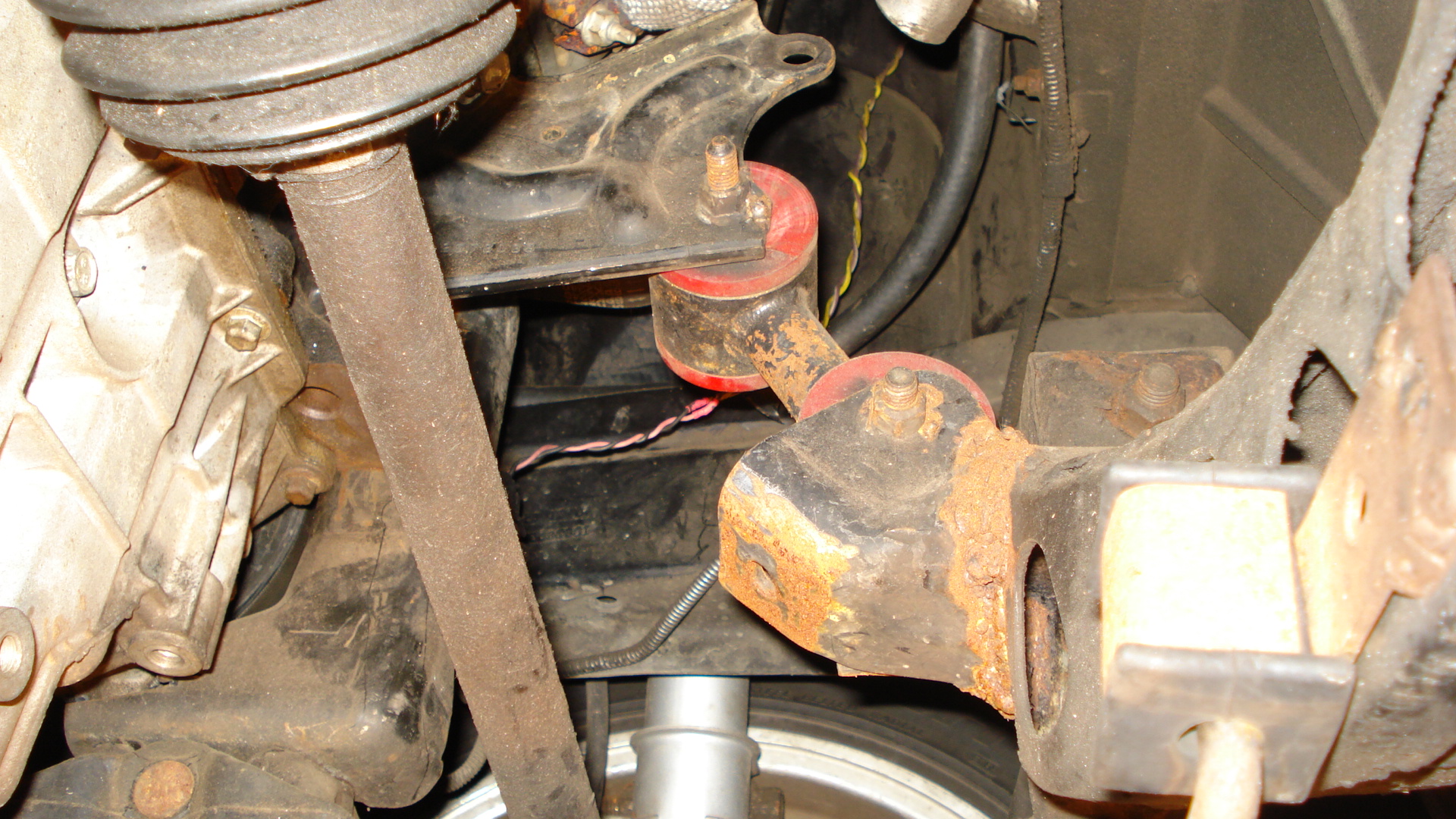

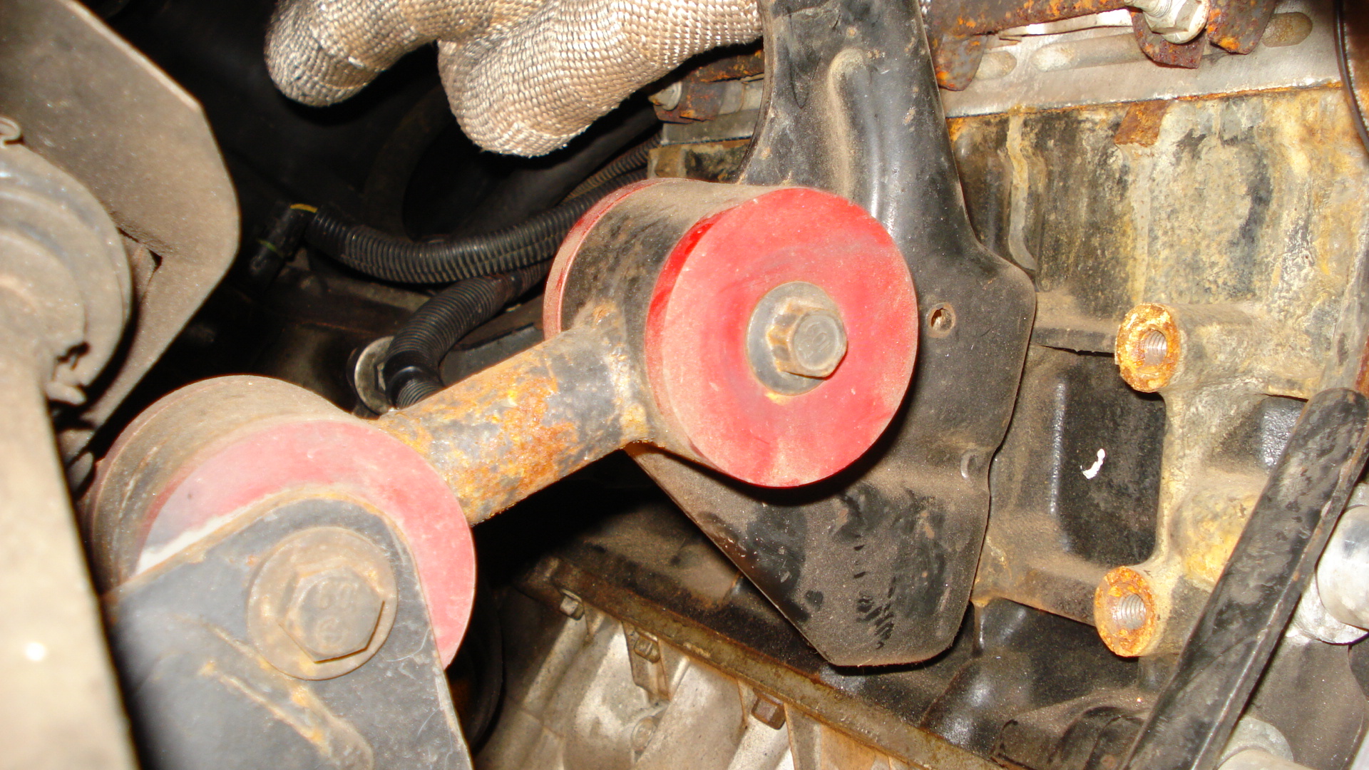

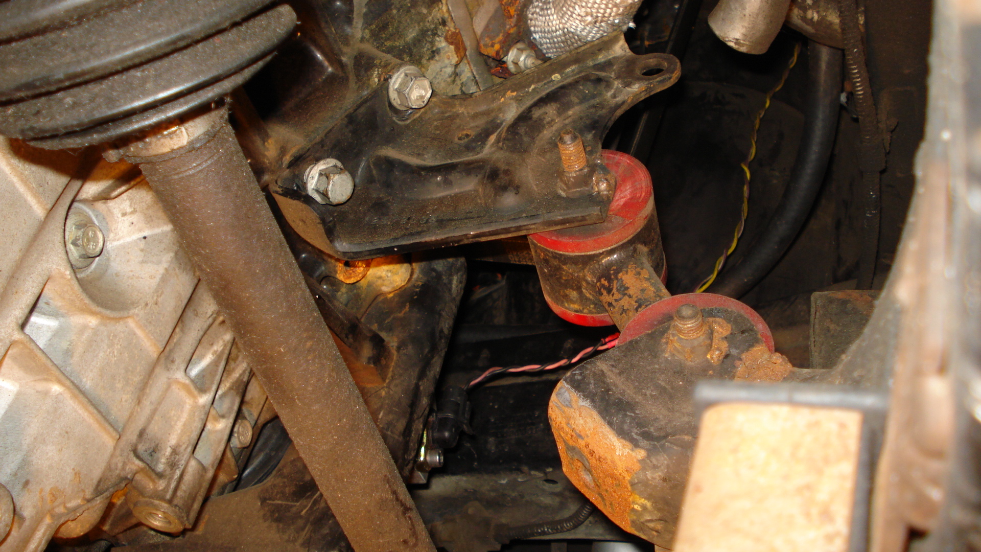

    the backside of the motor, i have a poly dogbone mount. but its only a braket on one side. the other side is a bolt head against the poly. this doesnt sit well with me. pics will soon follow. after work.

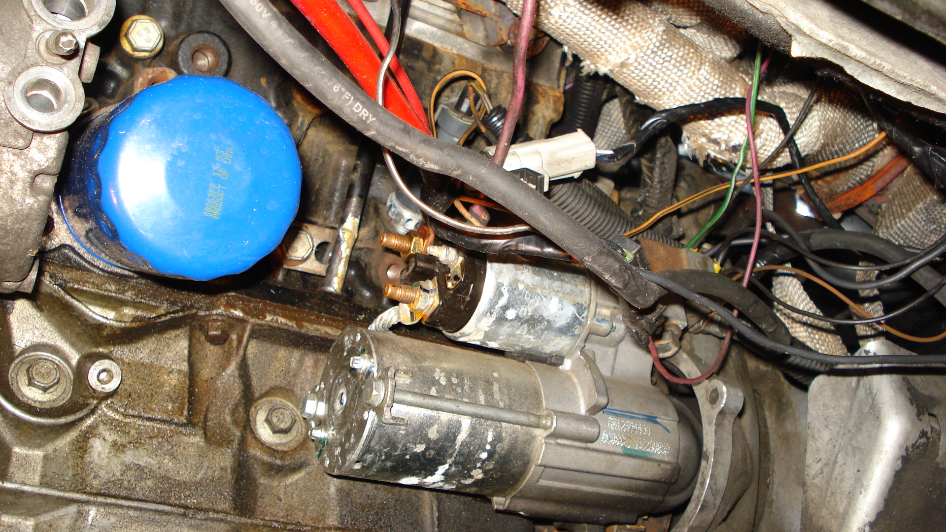

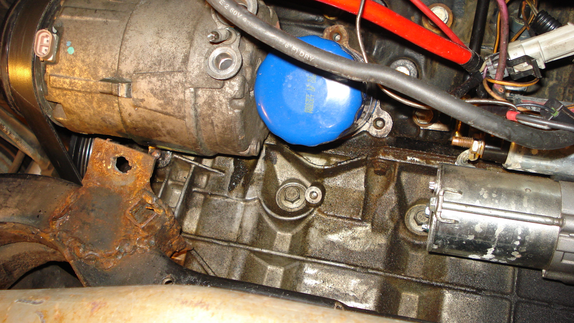

    the front of the motor, there was some 20ga or so steel flappit sticking up with a hole cut in it to fit a bolt through to the oil pan. the bolt hole is right under the compresser. it has a bolt broken off in it. its forever stuck in there after i tried welding a bolt to it so i could unthread it. but that was the motor mount spot for that side of the motor. that also doesnt sit well with me since its bolting into the oil pan. i cant think of anywhere else to make a motor mount on that side of the motor since the ac compressor, starter, oil filter and OPS are all on that side of the block.

          I haven't looked at your pics yet. From my understanding, you are not using the fiero front engine mount. Why not? The 3500 bolts in with the stock fiero mounts. You just have to modify the bracket that bolts to the block to clear the oil pan.
          Then you just make a custom torque strut. I don't understand why jon would mount the engine using the oil pan.
