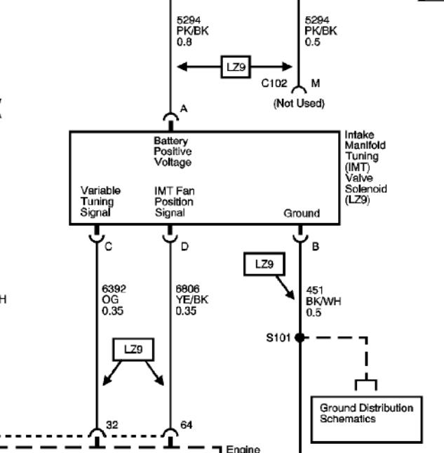

          Did you use anything to limit cam travel? I don't have the numbers in front of me but I measured the VVT travel on a CMM. The travels were something like +30 degrees and -24 degrees from straight up. IMO 54 degrees is too much for our needs. When I do another LZ engine, I plan to limit the cam timing to +10 and - 10 degrees from straight up.
          Wiring for the IMT is pretty simple. By grounding "C" the Fan closes, removing the ground opens it back up.
          Edit: "D" is just an output to the ECM to verify that it has closed

                    I got the wiring harness today and tested it out. It wasn't quite so simple. Either the power or ground must be switched and then another switch to ground to actuate the valve. If I tried to ground them together it would not work. If i left both grounds grounded and switched power it would not work. It doesn't matter too much because in my screwing around I managed to short out the actuator. What's another hundred wasted? Back to the drawing board I guess.
                    • #25
                      I connected "A" to 12vt and "B" to ground. Whenever "C" was connected to ground, the IMT fan would open. When "C" was removed from ground the fan would close.
                      The LZ4 intake without IMT fits with no problems. I picked up an LZ4 intake and would like to dyno with both to see how much difference the IMT really makes.

                      • #26
                        That's how I had it working also. It would just need a switched power to not kill the battery and a time delay to energize the valve because it doesn't seem to work if I gave grounds at the same time. Have you dyno'd a stock 3900 yet? If so what numbers did you get and what transmission did you use?
                        • #27
                          Strange that your IMT operates differently but who knows. Mine is wired to power on when the key is turned on.

                            • #29
                              Mine toggles positions by grounding/ungrounding "C". No other wires have to be disconnected.
