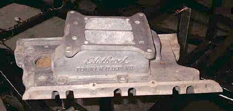

      Edelbrock makes a nice manifold 2 or 4 barrel, the 1.6 rockers help allot.
