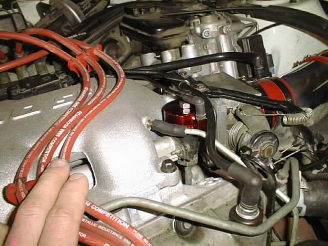

      You could do what I did with my old TB... Go to an autoparts store and buy an old carburetor spring and rig it up to close your TB plate. Let's see if I can find a pic of what mine looked like...
