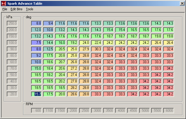

            Since 89jyturbo already said he was fine with sending his file to people and I already got one from him in the past, I will post what he send me that will get you started

              You might want to fix the kPa scale on that map, 60 and 70 are switched around. It'll still work like that but if you need to make adjustments, it's best to avoid confusion especially with this map.

                Thats helpfull! thanks!
