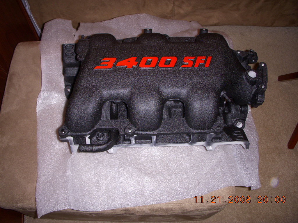

    Just got the Both done in "Black Wrinkle" and the letters are in "Mirror Red"
    The black will match the valve cover I put on last year and the red matches the intake tubing.
    Enjoy the pics

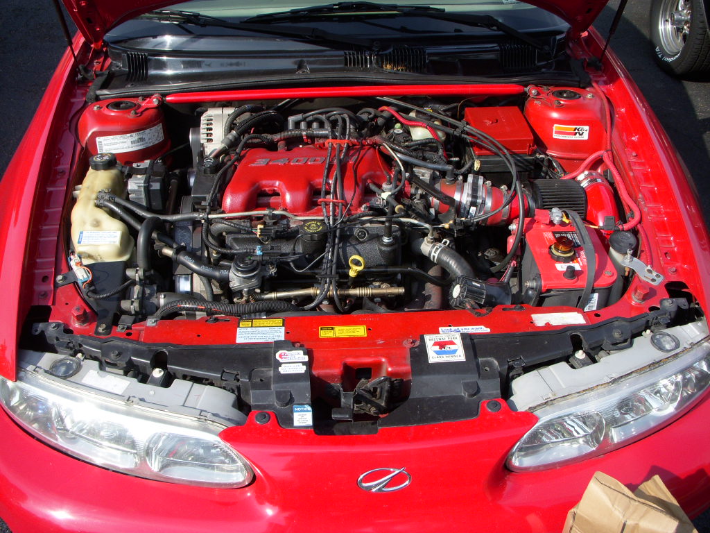

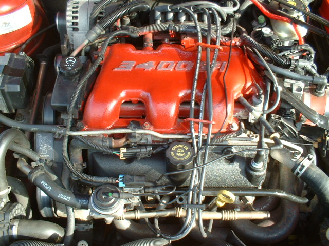

    Currently my engine looks like this:
    The lower mani currently has a small crack in it. My old mech did it when he overtightened the upper to the lower. It only has a small vacuum leak, but the car stumbles a bit more than it used to.

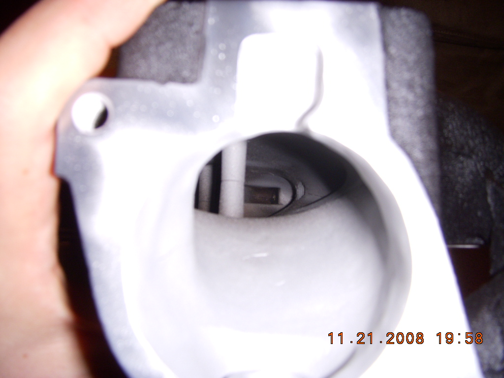

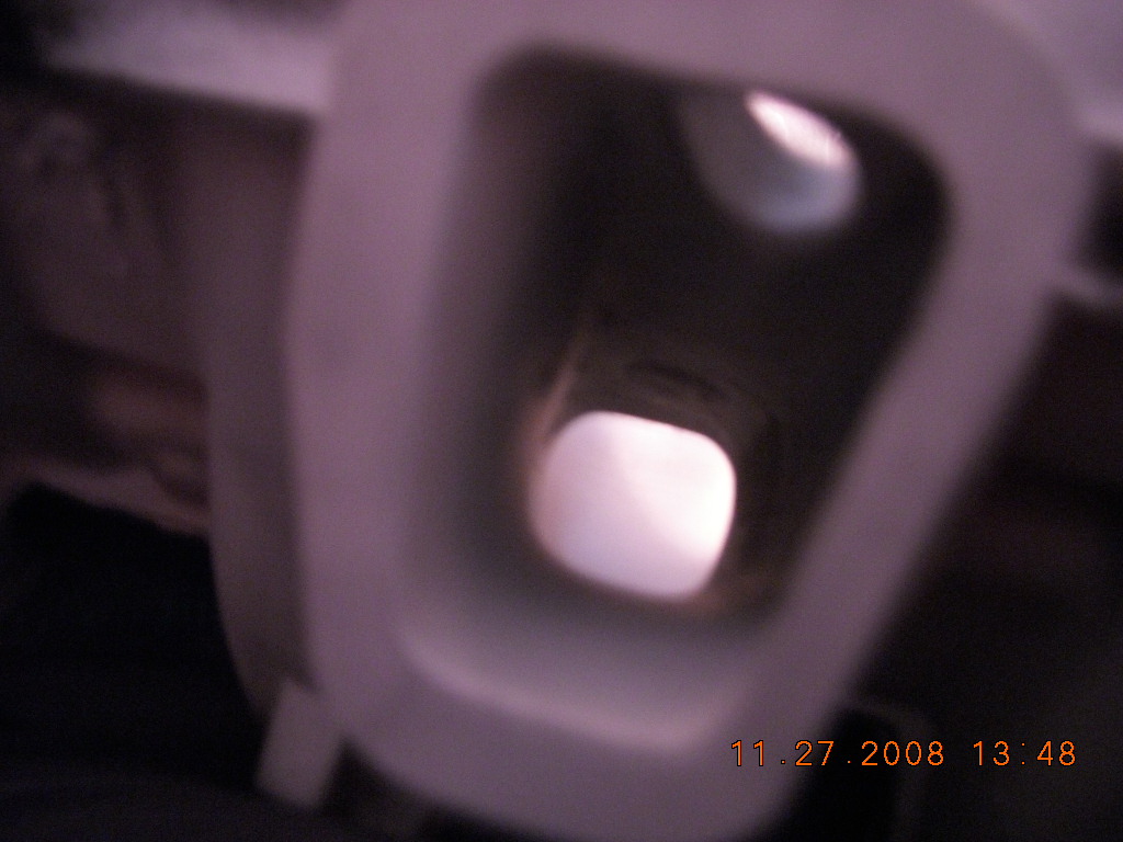

                Here's pics of the upper and lower ports:
                Upper is first, then the lower are the 2 last
                  try using the macro function, those are blurry as hell. I still need a pic with the gasket on there.
