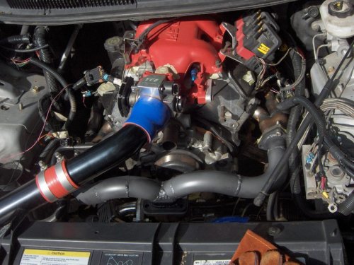

              So how will you get around the 3500 oil pan when you swap that over? It uses a different oil pan that is not swappable between 3100/3400/3.4 RWD etc

                  Ive never seen one in person before. Is it just the bolt-holes or are the over-all dimensions different? Is the sump any larger, smaller, any protruding bosses?
                  Heres a pic of my current pan and mounting position.
