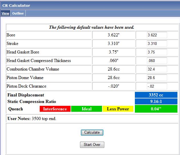

                Not according to the CR calculator. I used all the 3400 specs including headgasket since I'm using a 3400 headgasket and my cylinder heads are stock, so I assume they are the measured CC's minus a minimal amount since I had them surfaced... But this is what it comes up with just the CC's changed for the heads.

                    Your CR will be what i posted above if your using all stock dimension parts, forged or not. Now if you use a piston that says it will be 10.2:1 on a 3400 to get a general guess on the CR you can take the 9.5 vs 9.16:1 difference and subtract that from the 10.2 but if you know the new piston dish size the go to the cr checker on this site use all the numbers I did above but sub in your new piston dish or difference in bore dia an run the calculation.
