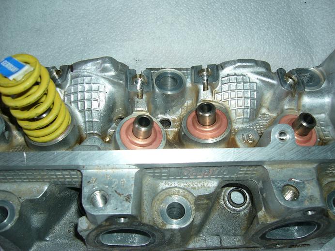

              I have a new set of the spring you see on this head, I bought off ebay a few months back but after seeing where they were made I was afraid to use them. If you think there good what seats and seals would I have to use?

                If those are the LS6 springs, then the LS1 seats are fine, you might have to open up the center hole with a die grinder to fi the 3500 heads. Use seals from a 1991 Cavalier 2.2L (FelPro part number SS 70816), you'll need two packs.
                As mentioned in that configuration on the 3500 heads, I measured a solid heightt of .5613" and you should be fine with up to .520" lift or so.

                    those have the same tags as my old yellow LS6 springs.
                    they're good for about .510 lift, and will handle that H260 cam without a problem.

                              As I said before, so long as those springs have the same stacket height (coil bind) then you are goo to about .525" lift without problems.
