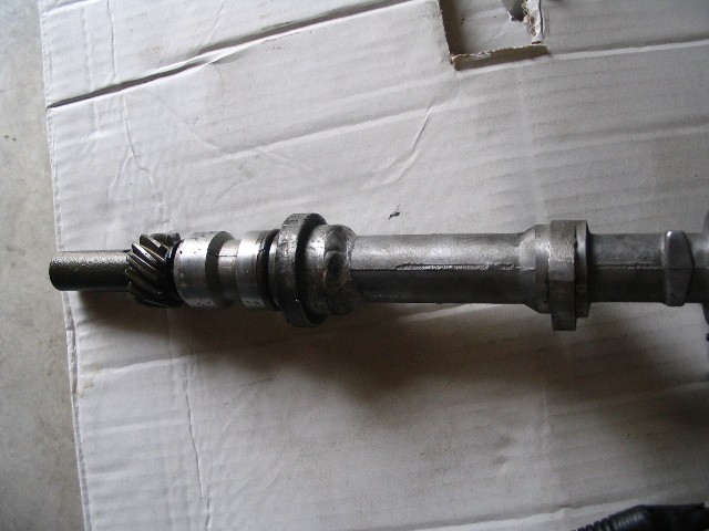

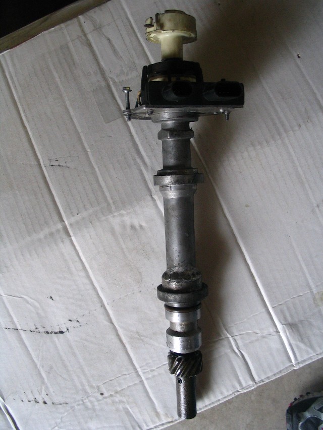

        I know the one that you are talkinga about. They guy who did it said something like he welded a 350 dizzy shaft onto the 2.8 dizzy's top. That cleared the LIM for the 3x00s.

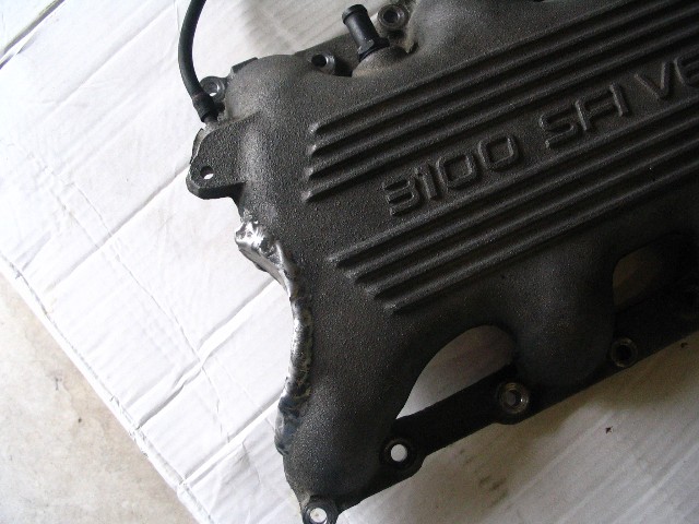

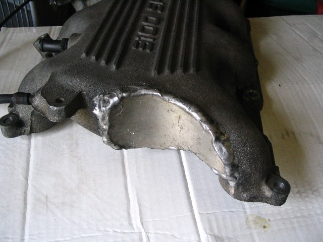

        • #19
          that would be me here is the pictures it's not that hard to do and I just bought a 3500 for the heads and intakes to use on my 3.4. I was thinking about using coil packs this time but the 3500 UIM looks like it may be a little less notching for the dizzy and if it is I'll go with it again. I just started disassembling the engine tonight and tommorrow I will know for sure if it will have more room.

              I haven't used the dizzy on a 3400,3500 it was a 3100, but I now have a 3500 I'm fixing to take the heads and intakes off to use instead of the ones I have now. I just looked at the 3500 runners and the bottom runner is offset to the inside so I don't see any problems and the 3500 UIM seems to be a better fit than the 3100 I have now. I'd say it was the dizzy cap the was hitting the LIM on you thats why I took a 350 dizzy and cut and welded it to a 3x00 oil pump drive so it would clear. My other motor was ran with the set up.
                    That's a small port UIM. The later ('00 and up) 3x00's the port is larger and you would think that mod would impede flow.
                    Since you have a 3.4 already, why are you making this modification in the first place? Your ECM can run a distributor or a coil pack (ICM).
                    Moving a couple of wires around is a lot easier than cutting and welding - possably cutting off circulation to one cylinder...
