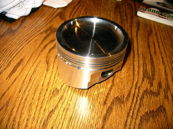

      did you have them lower the ringlands? im just wondering cause i dont want to run into problems with the top ringland breaking.

          You used the 3400 gasket in your calculation, 8.79 would be the compression. You have to remember the 3500 gaskets have a 3.8" bore. It's not as important in a low compression motor, but I'm going to be over 11:1, and every tenth of a point helps .
          EDIT: Pistons will be fine if tuned. You can get a boost cam profile for a few extra ponies, tell the supplier what you have and they will give you suggestions on profile.
          Stock rods are very strong, just upgrade hardware.
          If you overbore, your compression will be raised. Keep the walls as thick as you can for boost.
          EDIT again: I can't believe you put a S/C on there with NO extra added fuel?!? I hit the rev limiter on my car causing a lean condition and spun a bearing at 7psi. Sounded like a cannon going off, lol. Rods will be comming out soon for inspection, but the pistons are all fine (stock cast).
          you should measure a 3500 headgasket.. the bore is actually like 3.74" VS the 3.4 Iron head gasket that's 3.71"
                Could have sworn I did . 3.8", but I'll check again.
                • #23
                  3.8" on the nose
                            Maybe it's because mine were used..??
                            weird.
                            I'll check again, they're still hanging on the wall.
