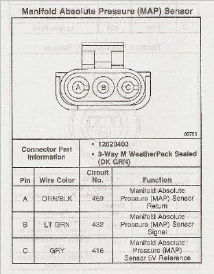

                Does anyone have the pin outs for the 3500 map sensor? I was helping someone tune their car yesterday and we where having a problem with the map sensor. It just showed 77 Kpa all the time and didn't move at all with the throttle, and it showed 77 for the barometric pressure too which isn't right at all. He's got a 99 grand am se 3400 with a 3500 top end swap, and is using the 3500 map and 28lb injectors. Ben made him a harness for the injectors and map. The 3500 map should have the right output signal and should work with the pcm right? So I'm thinking either the wires are in the wrong spot for his car's harness, or the map itself is bad. Gonna try to get the 3500 map to work so we don't have to switch back to the 3400 map and adapt it to the mani. Here are the wire positions for the stock harness connector.
