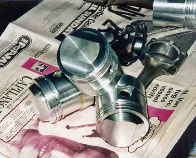

          my 16 miles 3400 block had the nr.6 piston for breakfast though.
          the pinn wasn't moving freely on one side of the piston and this situation scuffed the pistonskirt and cylinderwall really bad.

            That skirt damage has nothing to do with pin oiling. Eek. That's a lotta heat, caused by a lack of oil. Why? Need to measure the piston to wall clearance, which is now destroyed....so, need to look at the other bores and skirts, but, this one cylinder could have not been clearanced properly and looking at the others might not yeild the answer.

                Well yes, if the pin was too tight it wouldn't allow the piston to center itself quick enough, thus dragging down the cylinder with too much side pressure.
