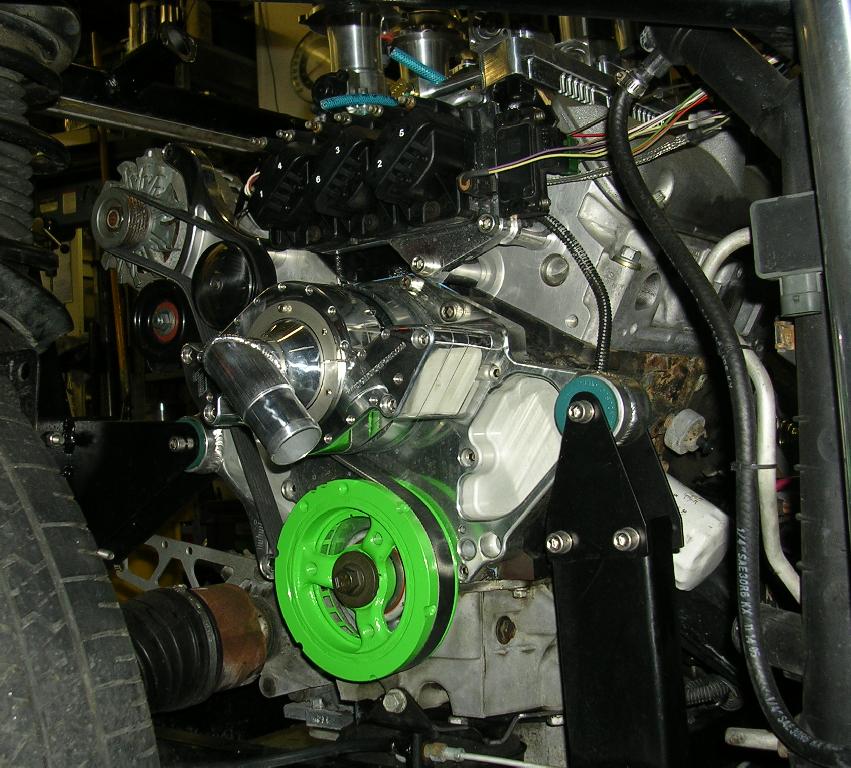

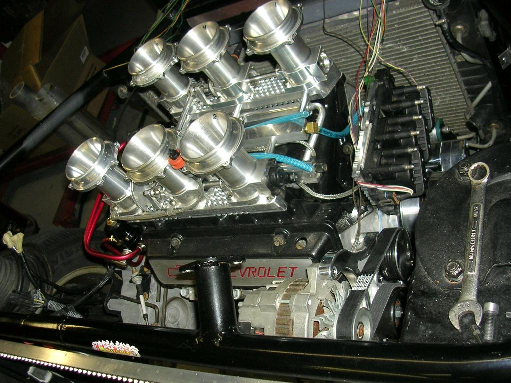

I have been making some parts for the Minus One for quite a while and decided that it was time to put them on before I start any more projects. I did decide to hold off on adding the twin T-25s for now but am bolting everything else on. The engine is a stock '95 3100 with a 4T65E transmission. Upgrades include 3400 heads & LIM, small reground cam, six 45mm TBs, headers, billet timing chain cover, billet ALT bracket, billet water pump housing and a custom wiring harness to swap from OBD-1.5 to a 16149396 ECM.
![](http://www.tcecnc.com/UPDATE01.JPG)
![](http://www.tcecnc.com/UPDATE02.JPG)
![](http://www.tcecnc.com/UPDATE03.JPG)
I still have to complete the engine mounts, throttle shafts and linkage, air filter covers, relocate battery, finish the exhaust, wiring and tune it with the wideband.
Yeah... I know... a little overkill on the exhaust.
But as I have said before, I am not looking for lots of power.
