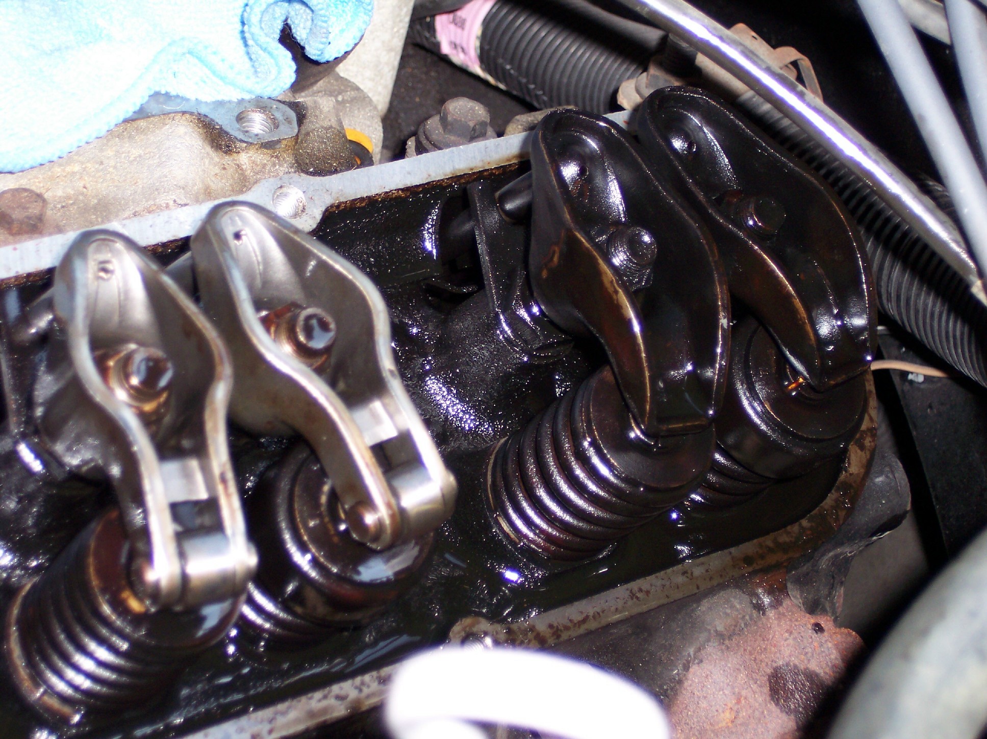

    What other mods are done besides the springs? All the time it takes to get into the valve covers, should have done more upgrades. Just put 1.7 roller rockers and new pushrods in mine since I had the manifold off...

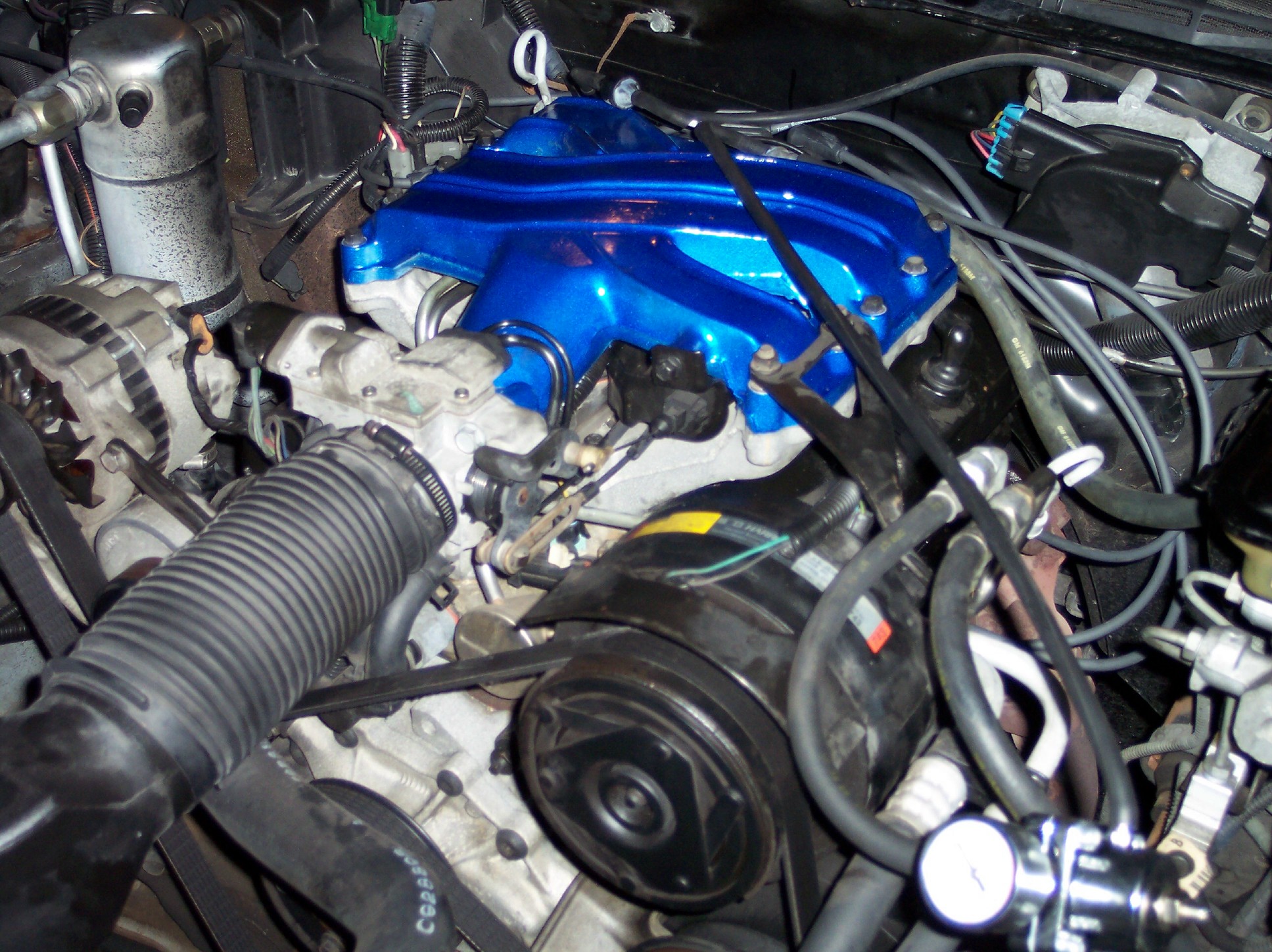

    And painted the UIM while I was at it...
    I know, I know, should have filed the casting marks of the UIM but didn't have time.
    Did you find a good deal on the springs? The exhaust valves are dangerously close to binding with the 1.7 rockers.
