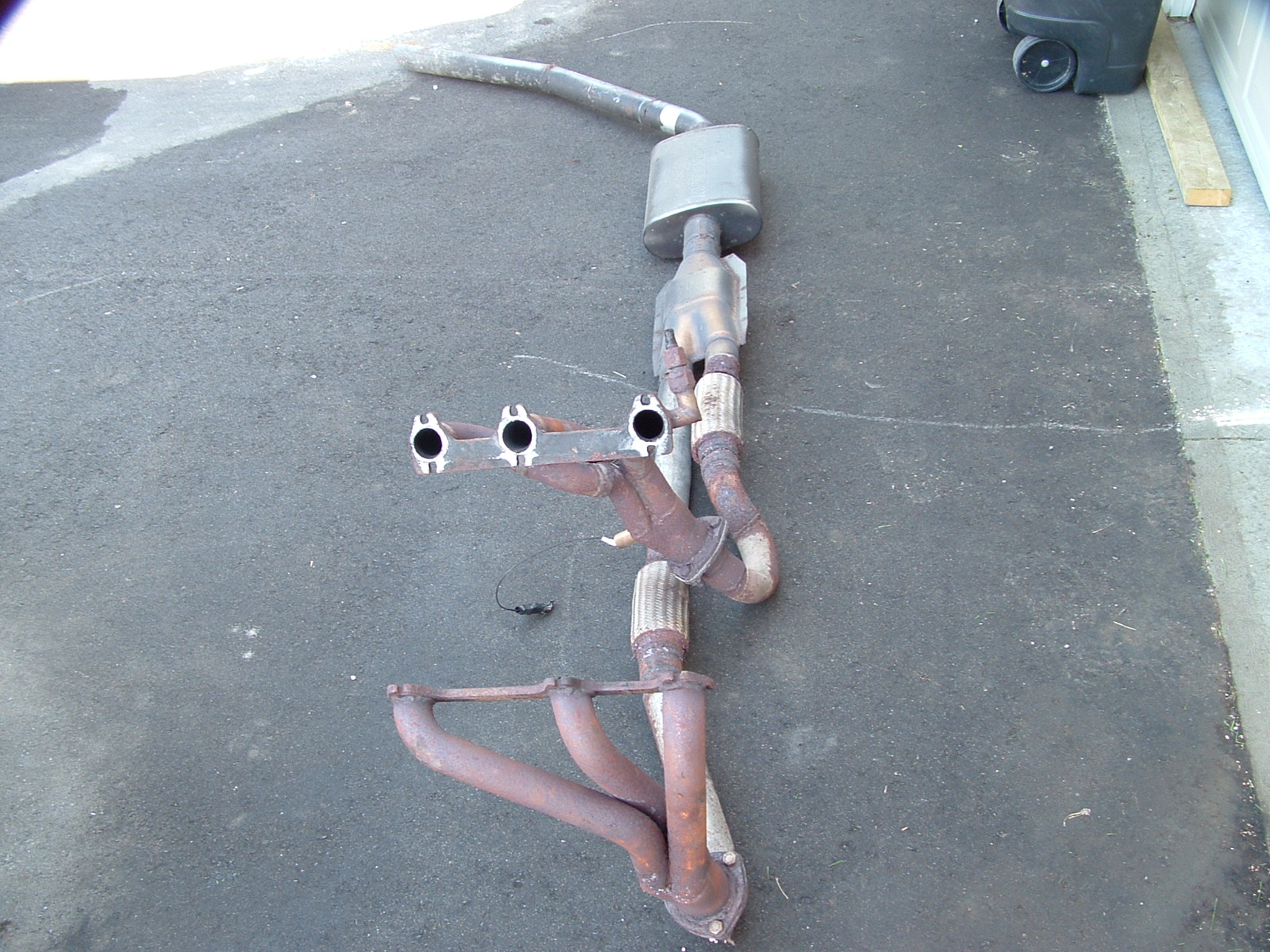

                  I did the S10 header rework for my car. The front was basically untouched except the bolt hole spacing is different. The bolt holes have to be stretched.
                  The back had to be completely cut, fitted and welded little bits at a time. Took over a week of work to do.
                  But the headers only cost me $100 CDN brand new.
                  Here's a picture of what they looked like when I took them off the car.
