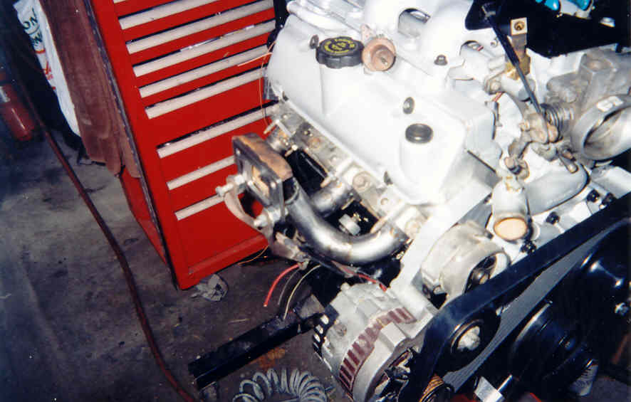

      I have a fiero and have just realized that this swap will place the alt up high is there any way to mount it lower to clear my decklid?
        I'm not sure this will help, but I moved the alternator for the factory location to the location where the A.I.R. pump was:
        The alternator was actually from a FWD genII 660, I used "1990 Cavalier" as a replacement alternator, the only variation that I know of between the genII alternators was a possible pulley size difference.
