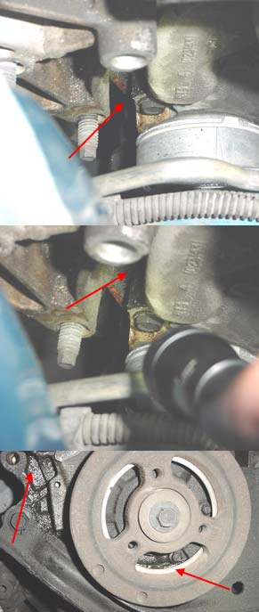

    Does anyone know if coolant can leak from a timing chain cover, and if the coolant circulates through the cover from the water pump to the other side on a 3100? It's either coming from up high on the timing cover by the firewall side by one of the bolts, or the headgasket is leaking, but it's hard to tell if it's that since it's kind of dry there above..
    EDIT: the right side of the cover is dry. The bottom of the cover is wet from where it has rolled down from the left side (bottom pic). The top two you can see the belt tensioner right below the bolt on the cover where the leak appears to start in that area. There is no coolant in the oil.

    Coolant does flow from the pump to both sides of the engine and the bolts in that area go into the coolant passages. The coolant passage is in the area with the numbers on it (top pics).
    It is hard to see in the pics where the leak is coming from but my experience has been that leaks usually develop around the gasket. If it is leaking around the gasket, the cover has to be removed to install a new gasket.
    If it is leaking around the bolt and not the gasket, you may get lucky and be able to reseal the threads without removing the cover. Pull the bolt out, clean it, apply sealer and reinstall the bolt. May be worth a try.

      Sounds like cover then if you say the numbered area is a coolant passage. I think it'd be odd for the head to just leak a tiny spot there. And it was wet a little up higher at one point but I cleaned it all off and now it only seems wet by the bolt hole/etc so I'm leaning towards timing gover gasket. I have the motor torn down right now (doing intake swap) so now would be a good time to fix it. Just got to get the crank pulley off. Too bad I don't have an UDP sitting by me at this time!!!
      Er... wait.. I have to drop the oil pan right? CRAP!!! that looks to be a MAJOR job then. I can't even see how to get at the bolts with the 4t60-e in the way.
      Maybe I will try just the bolt for now. Thanks for the reply!

        If resealing the bolt does not help, you can remove the cover without removing the pan. I have had luck pulling the front cover without pulling the pan. The pan gasket is like a rubber o-ring and will stay in the pan. Just put a small bead of silicone (1/16 diameter) in the two corners where the block, pan and TC cover meet. Then smear a very small layer of silicone on the surface of the cover where it contacts the oil pan. The silicone on the lower surface helps the TC cover slide back in and seals it.

            I've replaced the timing cover gasket with the engine in the car (it was a PITA though), so it can be done without pulling the pan, like Marc stated.
              Not entirely sure what I want to do with it. The leak is *minor*. Just a trickle and the coolant doesn't go down any over 6months. I may throw in a tablet of stop leak and see what happens. Or wait if it gets worse then do it. I dunno. Seems like I should do it, but it's not that big of a leak..
