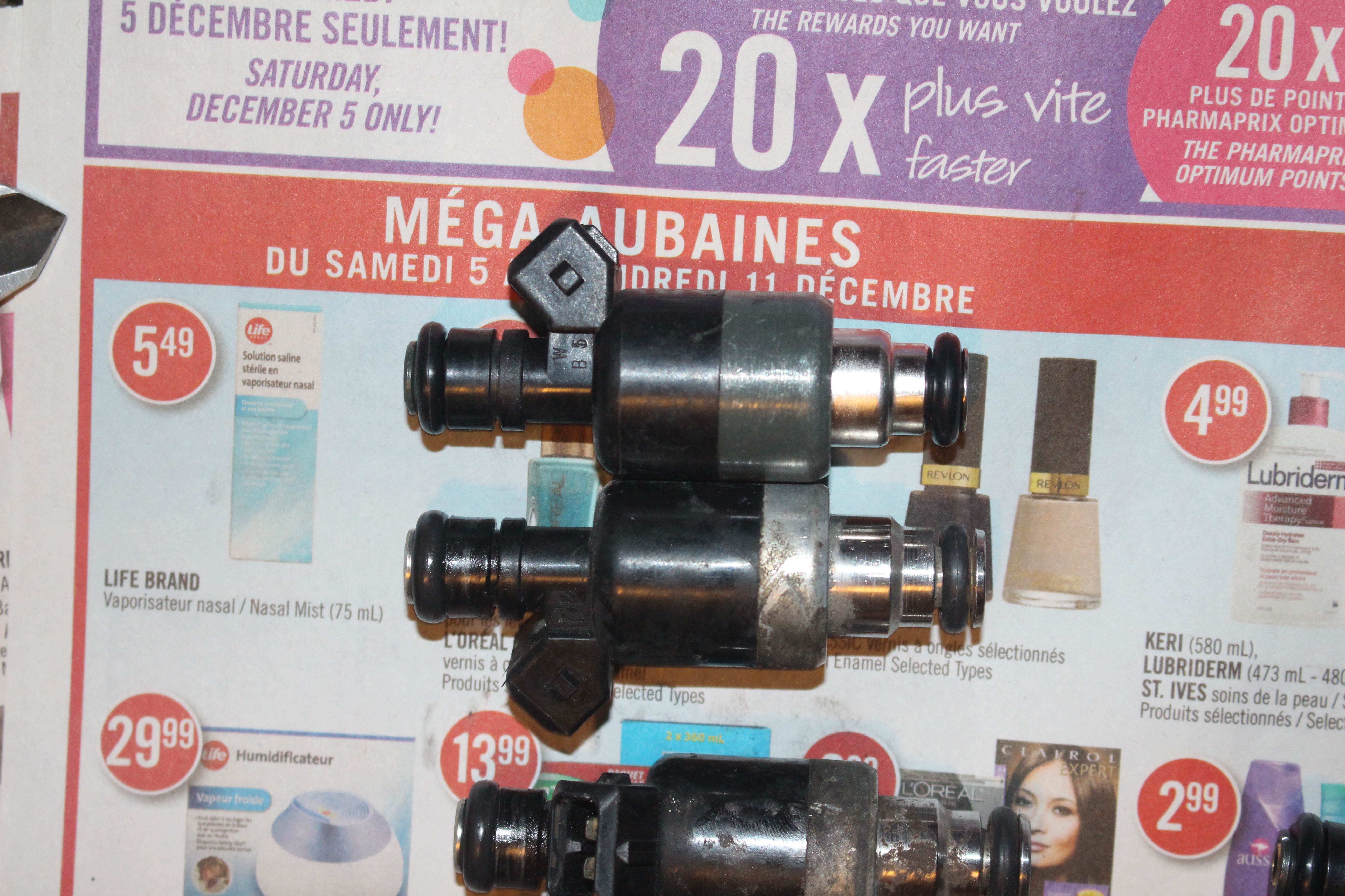

    now the problem i have is that the original ones from the car seem to be 3-4mm longer at the nozzle than the new ones. Should I be concerned?

    you can see the total length of the old vs the new
      side by side picture

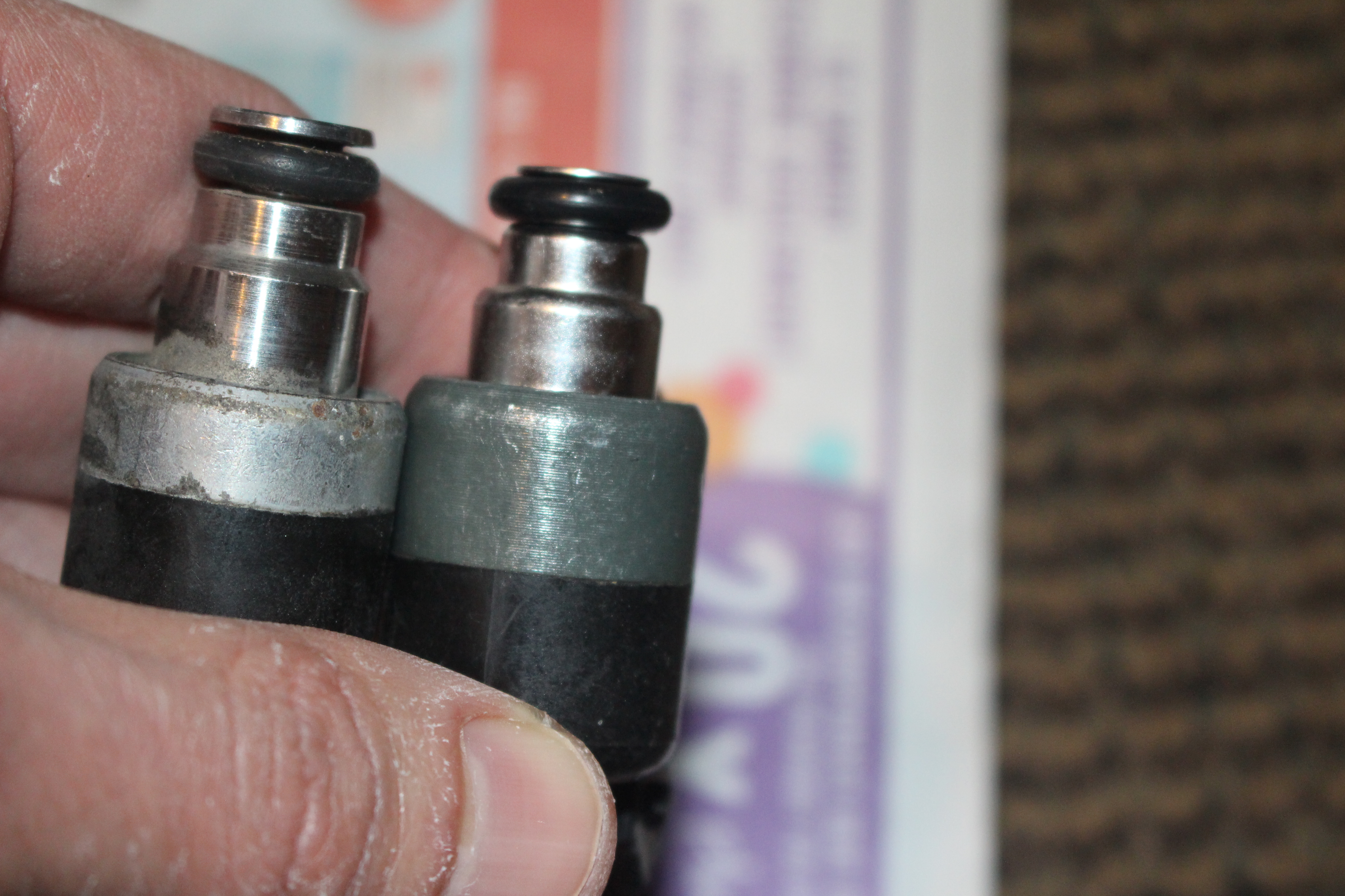

        much shorter but will it not seal up?

          should be okay. the longer injector appears to have move ring "slot" length and the o-ring looks like it would end up in the same location anyways.
            but the o ring ends up a tad higher
            there is no way to lower the fuel rail? nothing to adjust?
