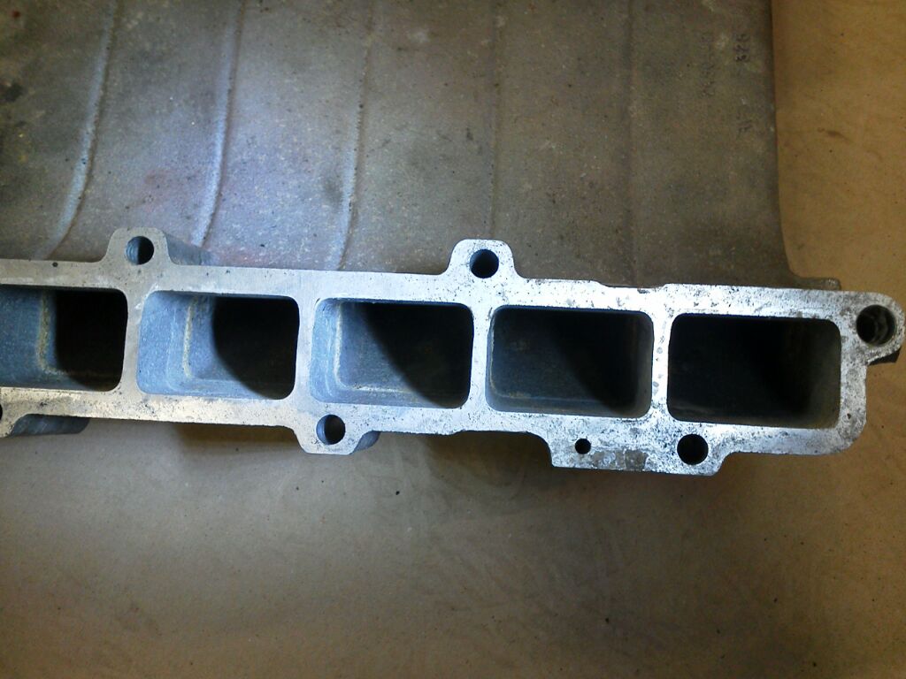

      Originally posted by carbon View Post
      Pics would be cool... carbon racing stripe
      Waiting for my wife to wake up (works 3rd shift) so I can grab my Sony Tablet. It's got a 5MP camera on it vs the crappy "who knows what and sucks at taking pics" camera on my phone. My digicam is broke :/
      • #18
        Sent from my Sony Tablet S using Tapatalk

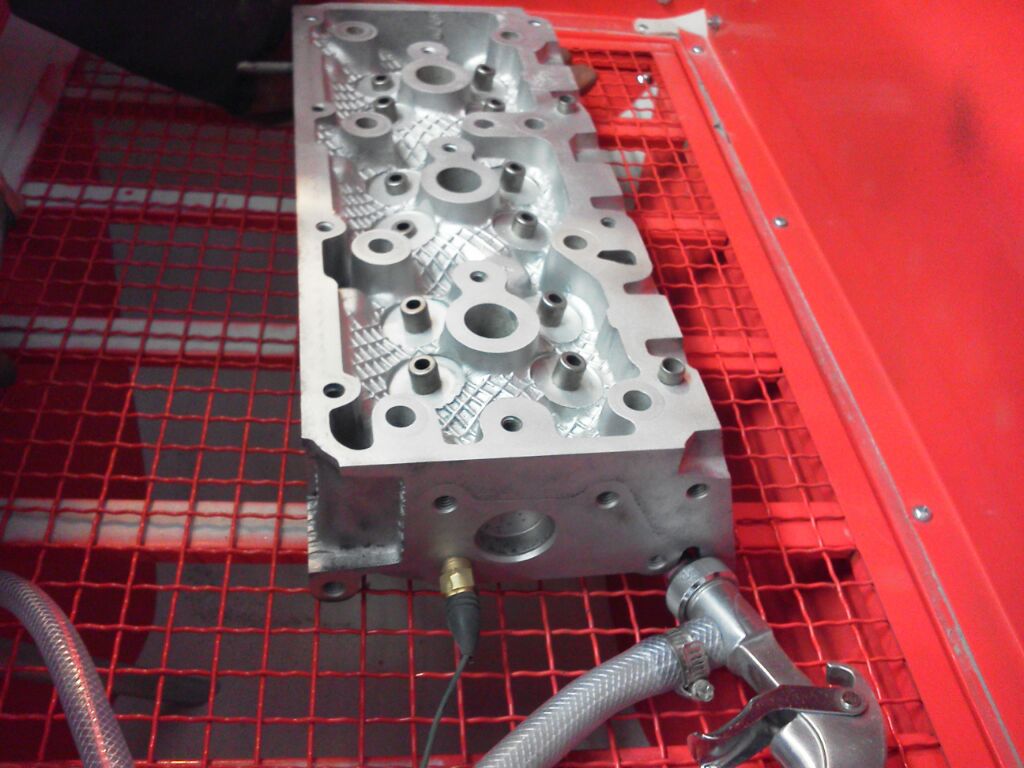

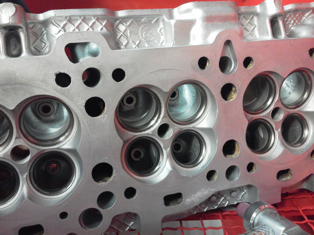

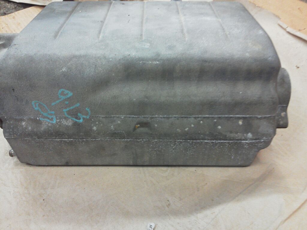

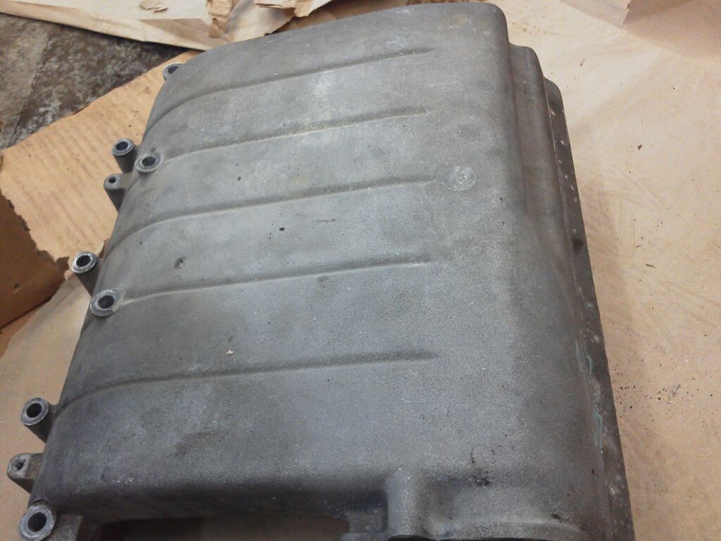

          Also, a bonus from glass bead on a nasty crusty head. The head looked pretty nasty before blasting.

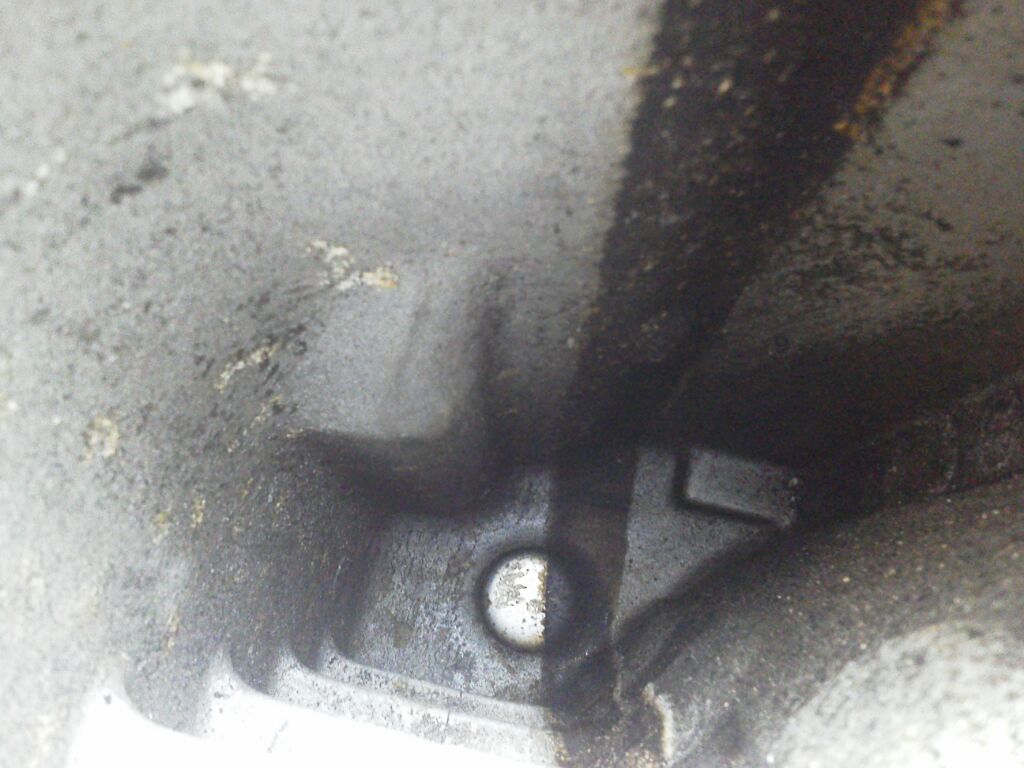

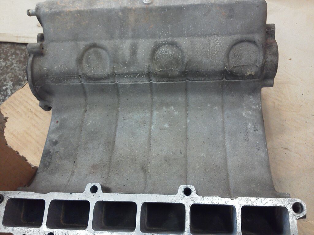

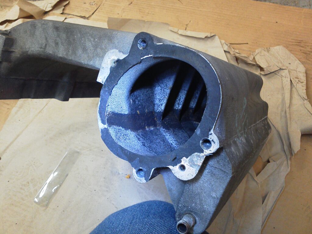

          Edit: I also want to reinforce what I said earlier. The UIM was a straight soak in 100% Formula 88 for a couple days, then turned over and soaked for another couple days. Absolutely no brushing, agitation or circulation was involved in it.
