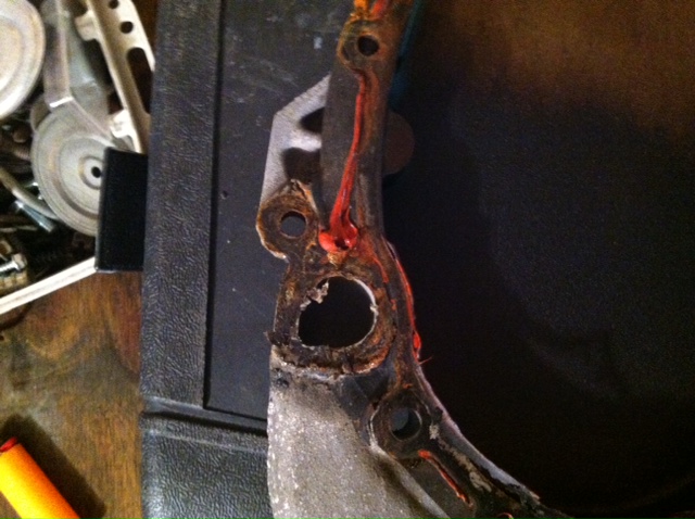

                        Found leak!
                          looks like it was changed in the past and very poorly... Now when going back in just put a thin layer of silicone around the coolant ports and be sure to put pipe sealant on the bolts that go in right next to the ports since they are open to water on at least one of them, I can't remember which one.
                          You shouldn't need to put a bead of sealant anywhere else but on the corners were the timing cover gasket meets the oil pan. The rest of the surface if clean should seal perfectly fine. I've never had problems with that leaking after doing what I described.
                            would black RTV work for the bolts too?
                              Yes but you really should use a good thread sealer instead. RTV gums up pretty bad and it's a pain to dig out of the holes for the next guy.
