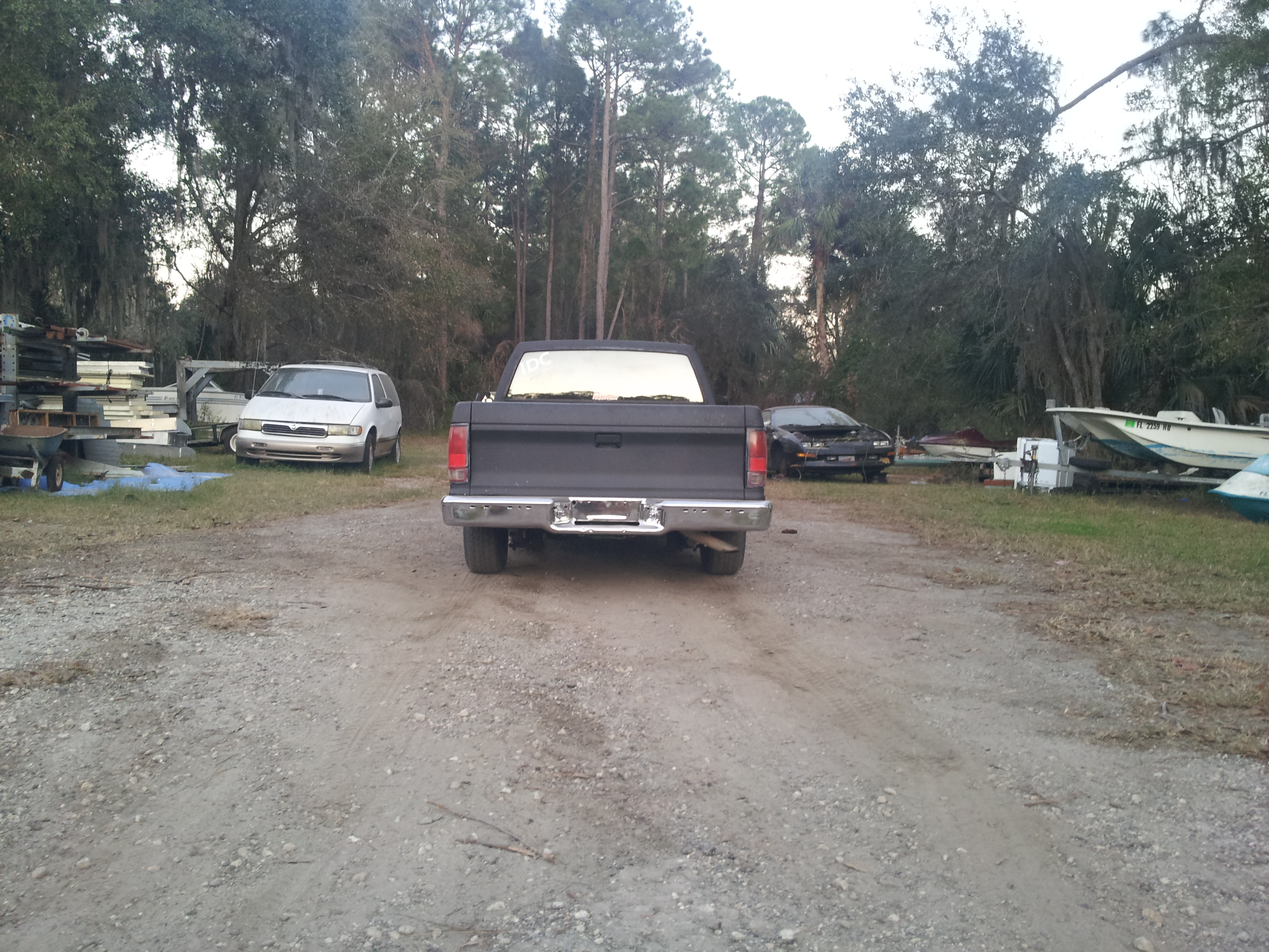

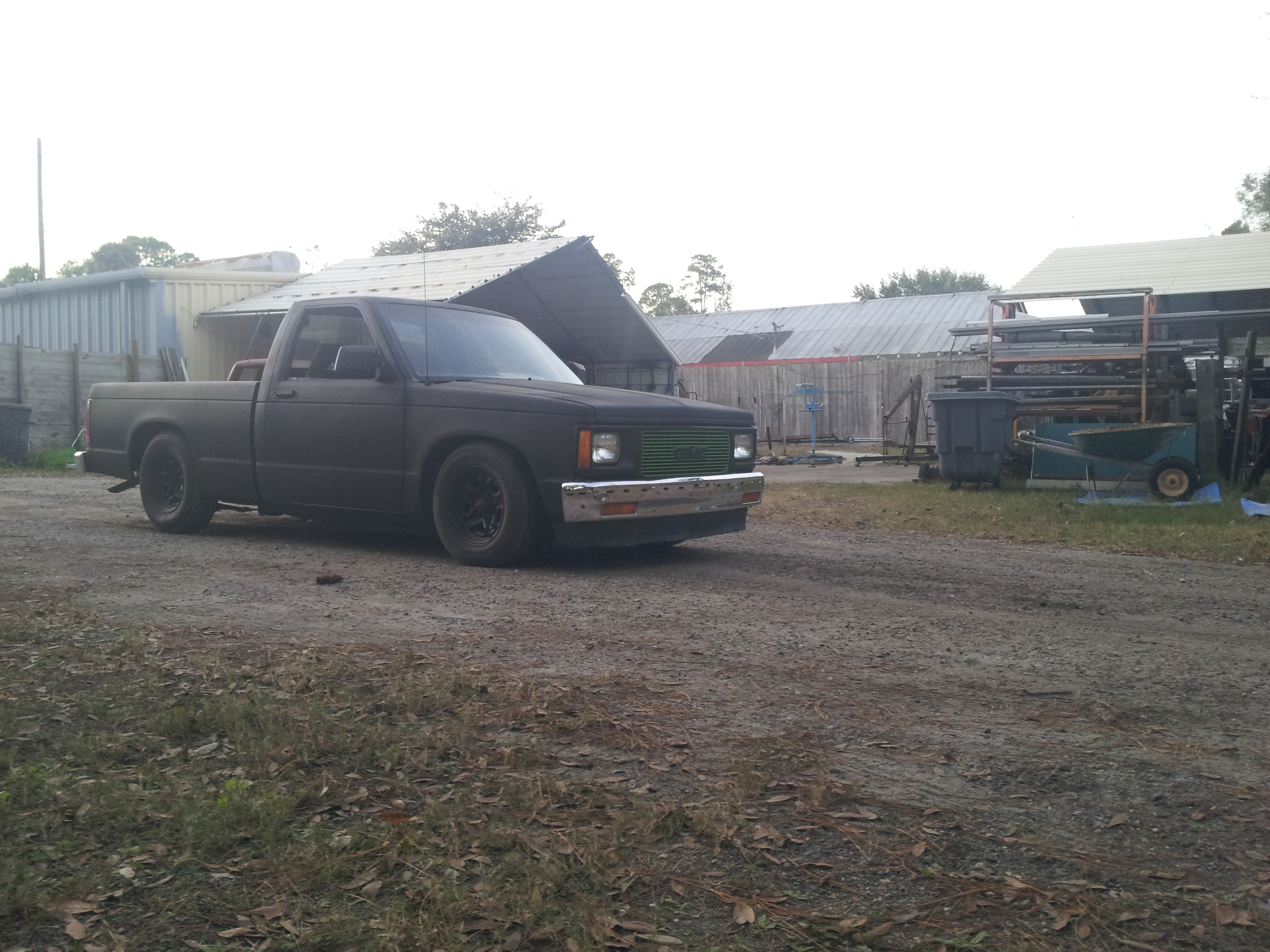

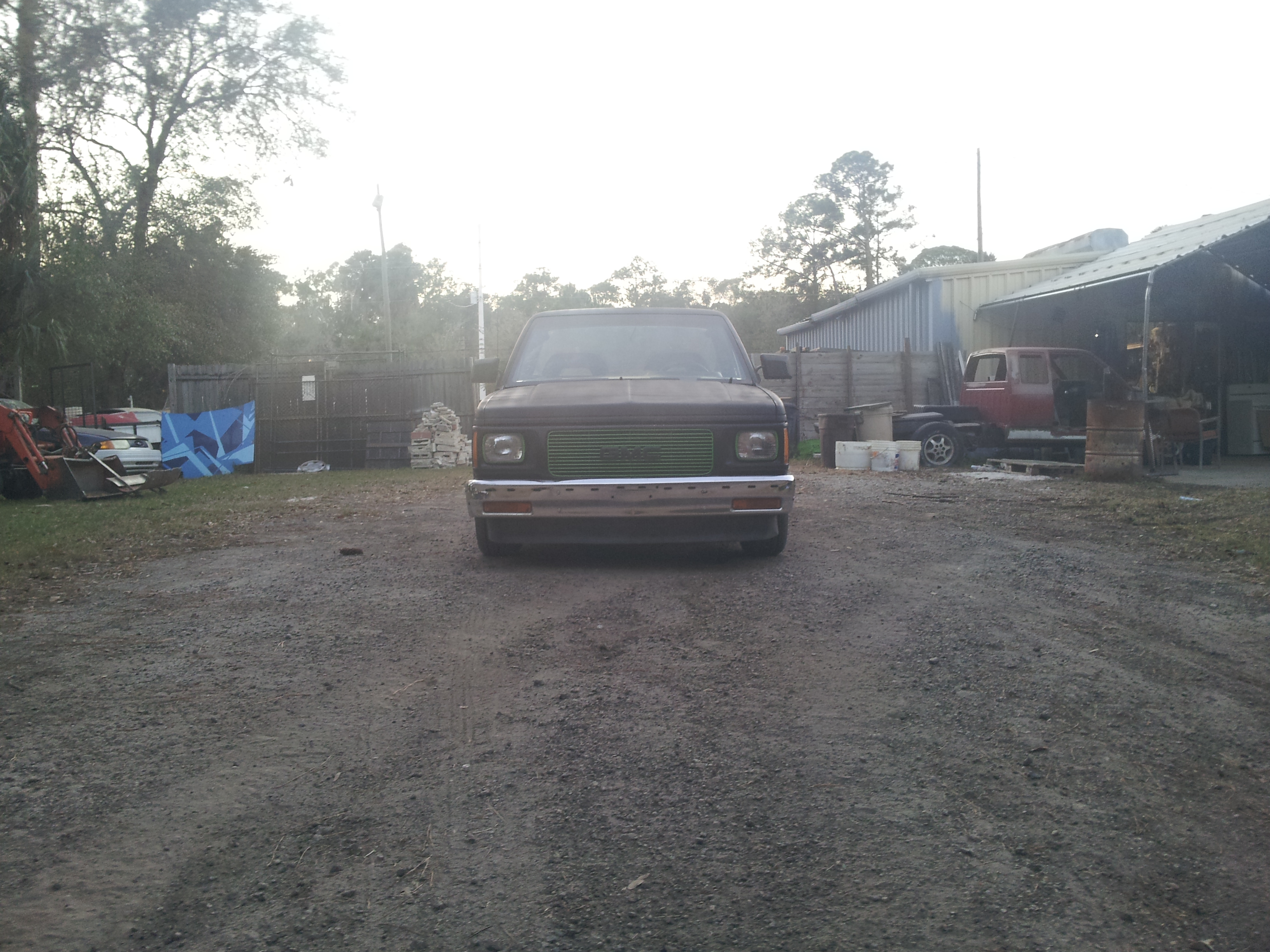

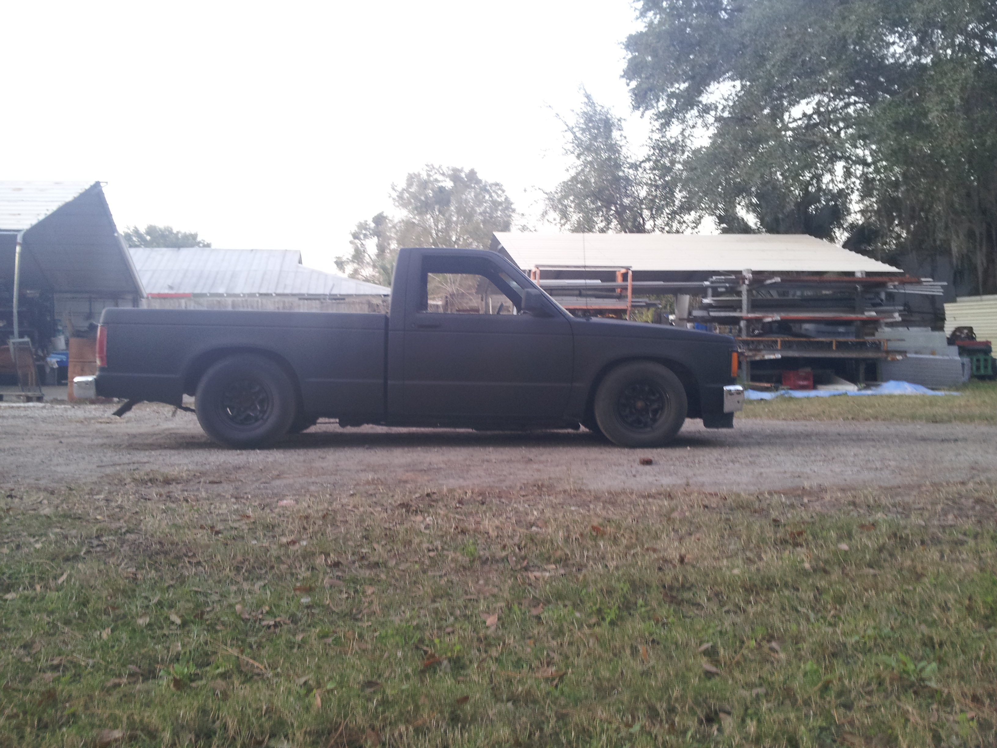

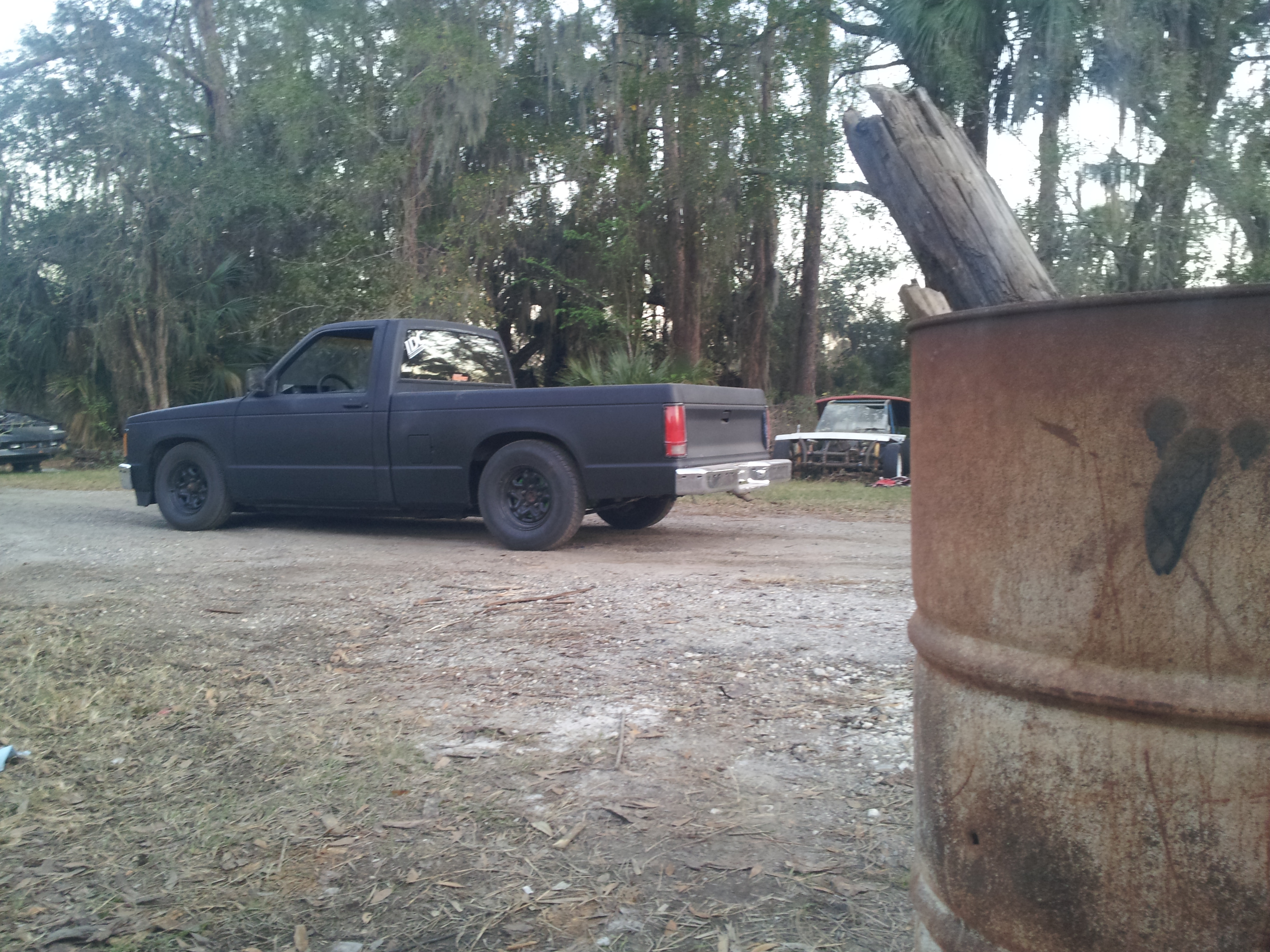

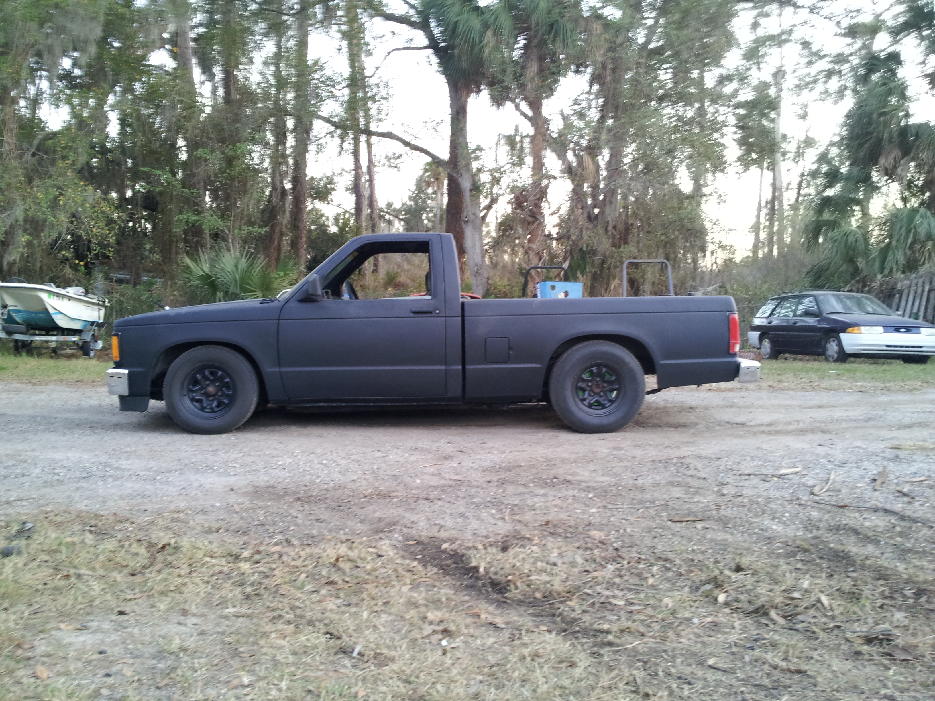

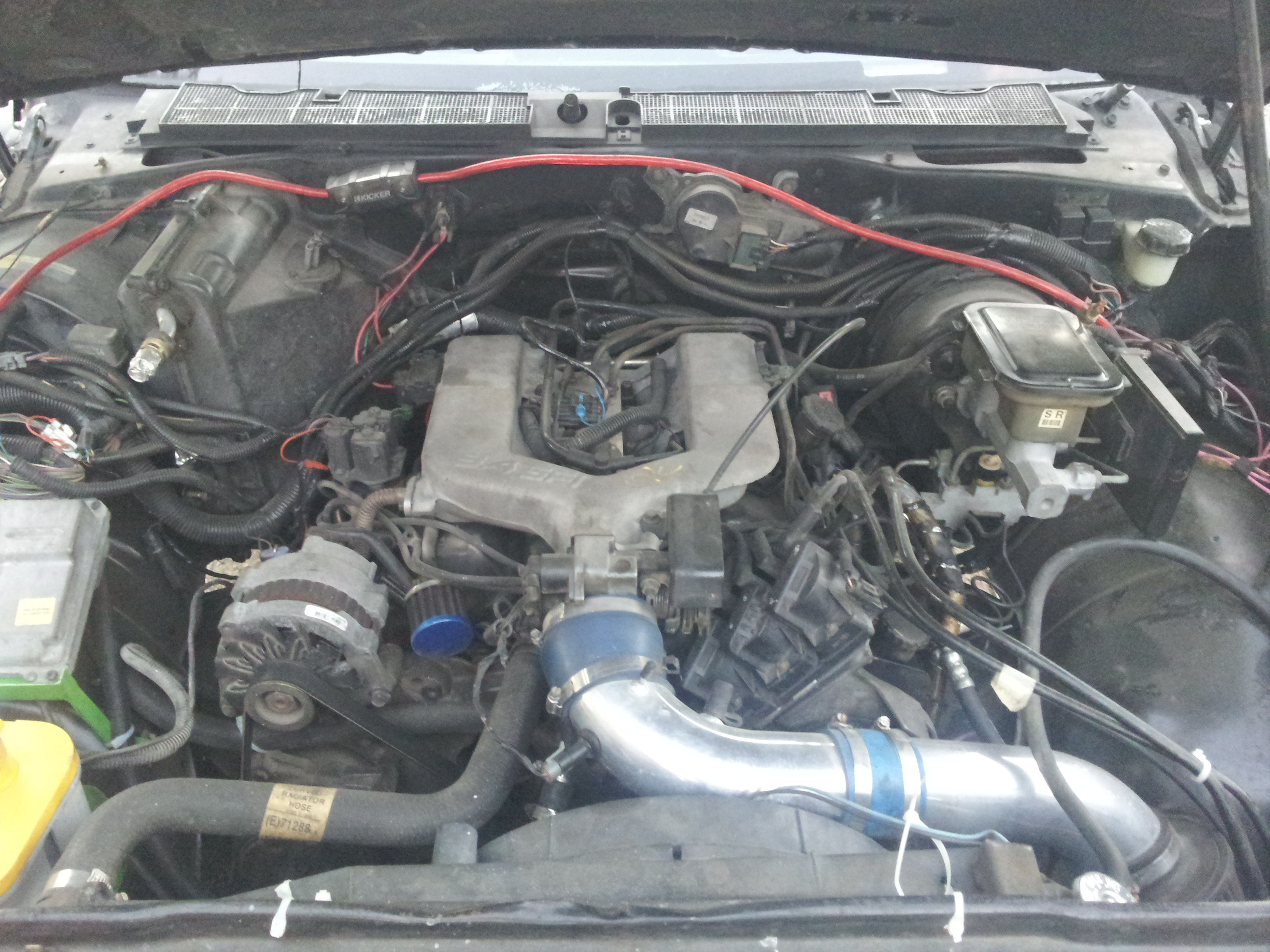

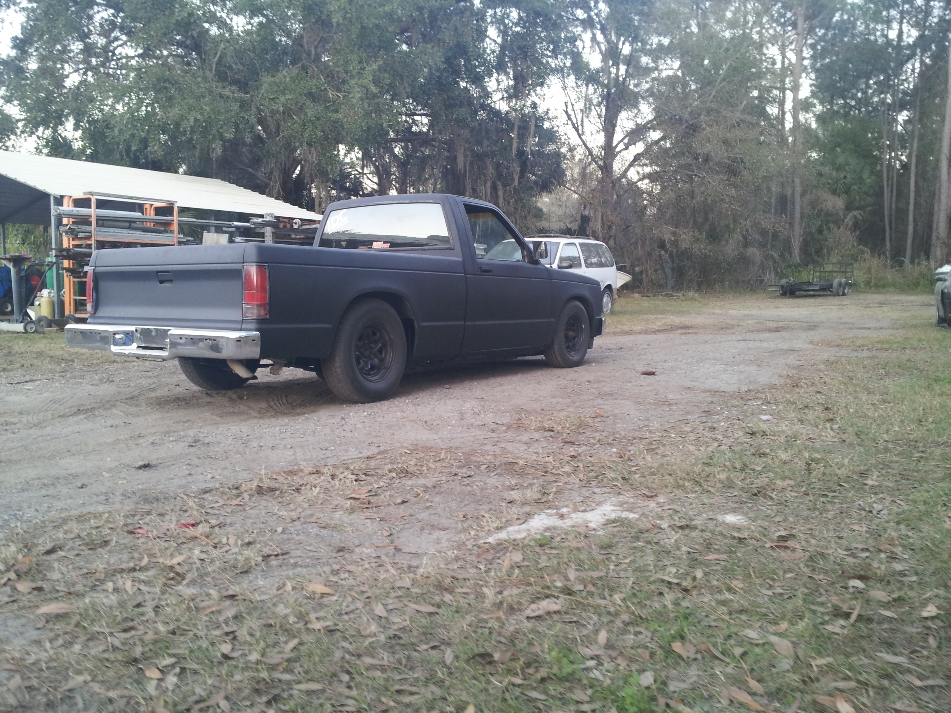

                post pics !!!
ID:	376965Click image for larger version
ID:	376966Click image for larger version
ID:	376967Click image for larger version
ID:	376968Click image for larger version
ID:	376969Click image for larger version
ID:	376970Click image for larger version
ID:	376971Click image for larger version
                    Not bad I'll bet its fun to drive
                      Yes it is but thank you though it has came a very long way
