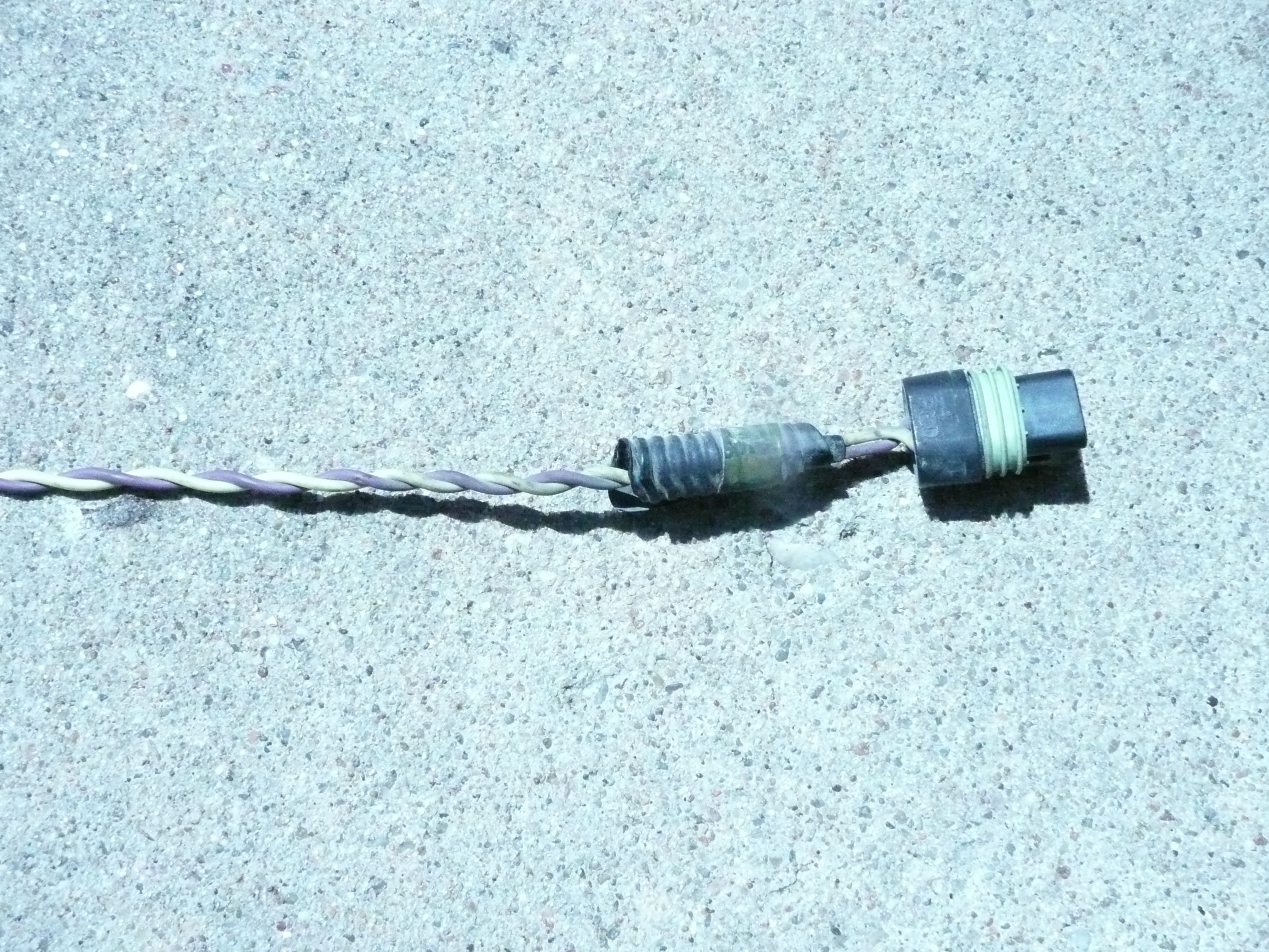

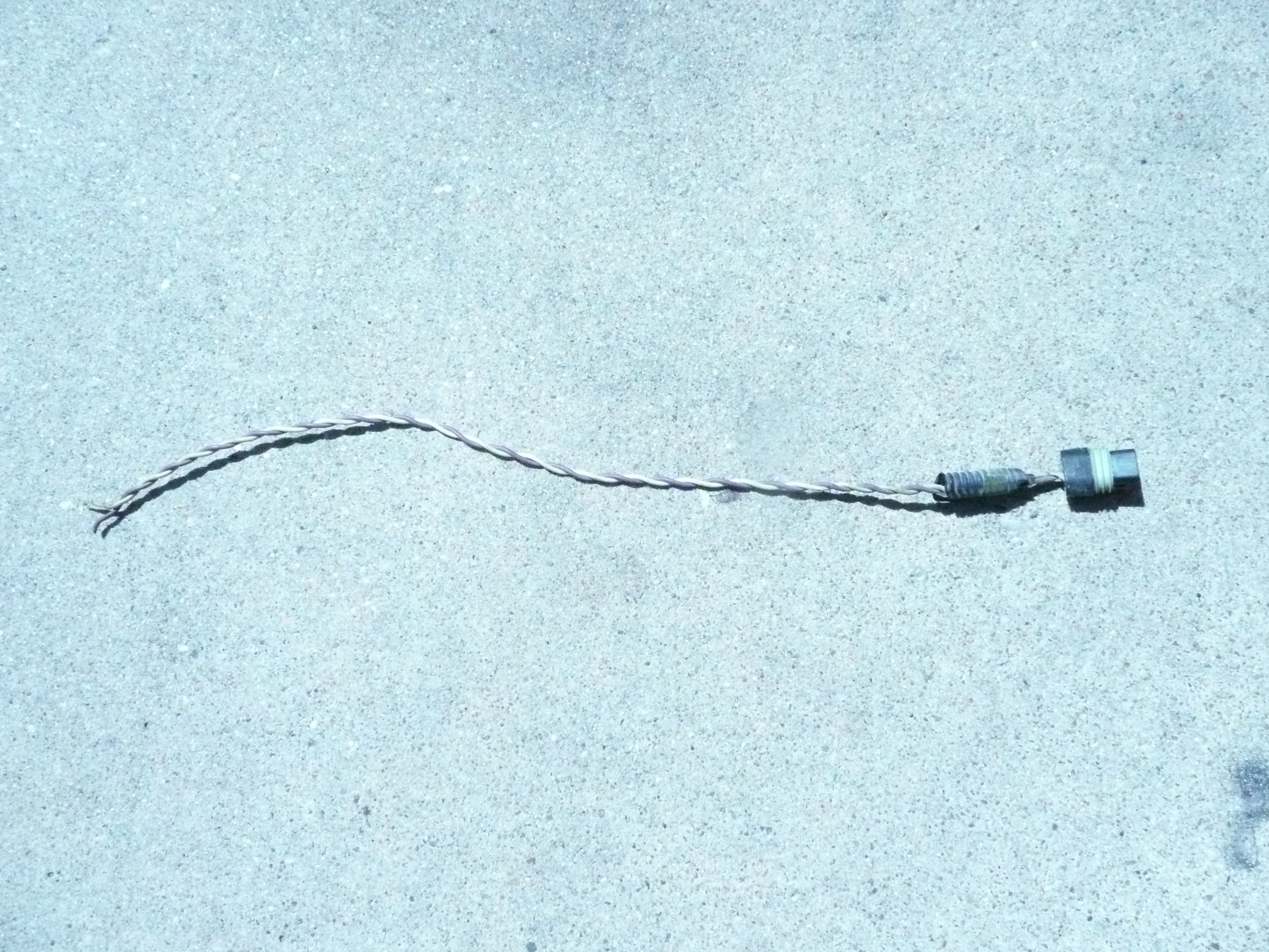

    Where does the paired wire yellow & purple go to after leaving the ignition coil module? The pair toward the driver's side firewall. See Picture.Click image for larger version

    It goes to the crank position sensor (3x) on the back side of the block.
