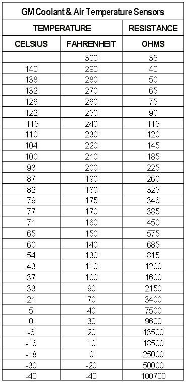

                      This resistance chart is from a Fiero, but I assume it would be the same. I've never confirmed if it's accurate for the CTS though, I only used it on a MAT sensor.

                        Originally posted by armos View Post
                        I'm a little late but just another suggestion - I'd try hooking up a known resistance to the gauge to confirm whether the gauge is in good calibration. It probably is, but it's worth checking.
                        Many GM temperature gauges from that time period have a wiring flaw that causes the needle to slam into the peg every time you start the car. It's trying to do a "bulb test" on the gauge instead of the idiot light.
                        However, I think that would normally cause the needle to be pushed lower, not higher, so it might not be relevant here.
                        [ATTACH=CONFIG]5993[/ATTACH]

                          I would also suggest placing the gauge tip in hot water with a known good thermometer and register the resistance. This may also show if the sensor itself is faulty.
