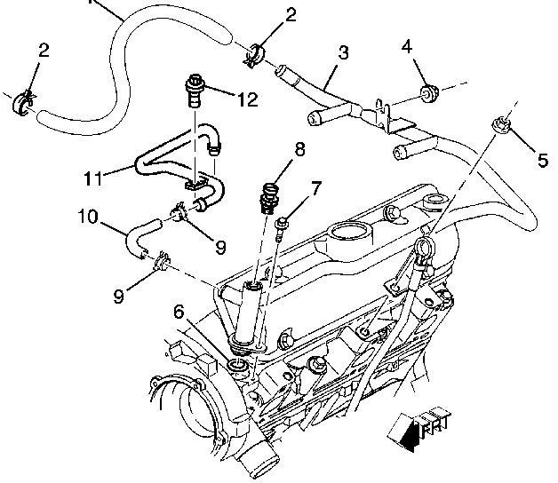

    I am finishing up on a LIM gasket project on a 1998 Lumina with a L82 (M) engine. I need the torque spec for the small bolt that holds the coolant wrap-around pipe to the top of the water pump housing. The listings on this site show a heater inlet pipe nipple @ 22 ftlbs, but I don't see this as a nipple.
    The attached diagram shows the pipe and bolt (#7). Also I found a small bead of what looked like RTV around the top of the bolt and wondered if this was some type of thread lock compound or thread sealer?
    I don't tighten that one by the book, but I do only use a 1/4" 6" ratchet to avoid putting too much torque to it to avoid stripping threads or breaking the bolt. I've never had one leak. I just snug it down good since there's an o-ring in there to do the sealing. I believe the bottom of the threads are external to the coolant passage there, if my memory serves me correctly.
      snug.. don't get too wrapped up in torque specs on things like that.
