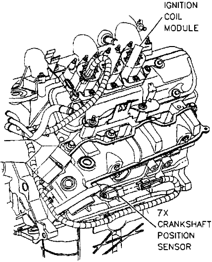

    Had to edit, I had a brain fart. Yes, there are 2 CKP senors.
    Better question is where in the heck is the other one? I know the one behind the balancer.
    Advice finding and replacing this thing? I hope it isn't a pita!
    sounds like you found the 24X sensor already... i'll post a pic in a minute of the 7X...
    EDIT: here it is
      Jack up the car on the passenger side, stick your arm however you can (tie rod hole, under control arm, whatever) and feel the "back" of the block (really the side). 10mm nut holds it on, then pull it out. has to be done by feel due to the huge 4t60-e.

          Actually, it seems I could reach it from above when the heads are off, which they will be soon.
          Thanks for the pic Rob!
