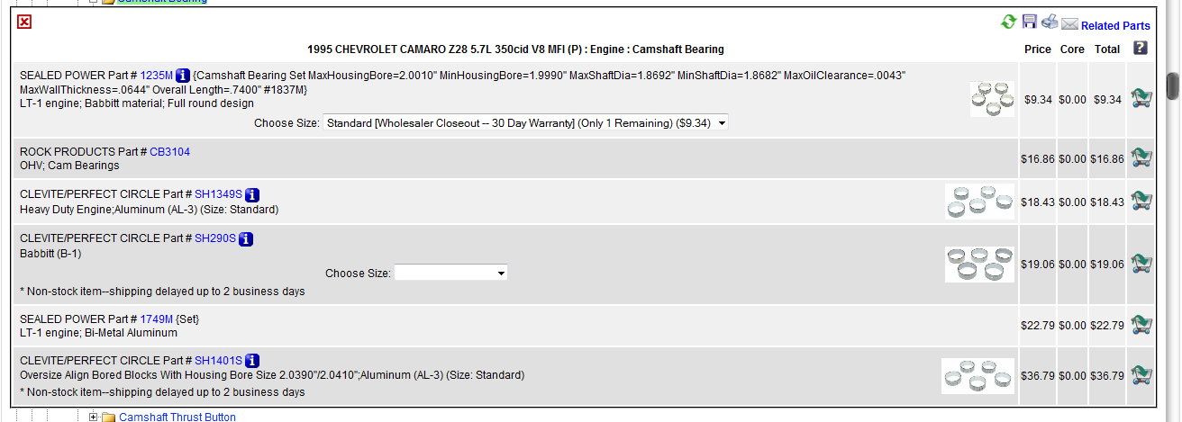

                what part number or brand are you guys using for SBC bearings. i did a search with rock auto on a 95 camaro with a 5.7. well i attached a picture to show.
                just want to know if there is one that is better than the other.

                    well if you click on any of the part numbers like the pic i posted from rock auto you get a wide range of years say from 1955-2007.
                    looking up a 69 camaro 350 it came up with all the same part numbers except this one was added in
                    ok it seems like we need Gen I SBC bearings.
                    and it seems like this is the number CLEVITE/PERFECT CIRCLE Part # SH290S
