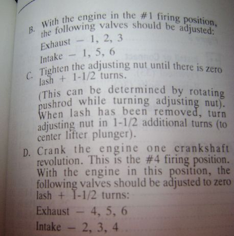

    newbie please tell me whats all involved in the adjustment of my rockers i have a tappin noise that is not up to my standards lol im no new mechanic just to the site so i just wanna know how long its gonna take and maybe tools??? gap??

      Actually, you might be better tell tell us what engine it is?

        If your talking older F body, vin S, you tighten while spinning puchrod with fingers, when there is resistance, Tighten another 1 1/2 turns
          Assuming that your nickname reveals your engine to be a 93-95 GM Chevrolet V-6 L-32 3.4L 207 CID VIN "S" engine, a more accurate piece of information comes now to you in the form of two screen prints of how to do this very valve adjusting job according to the proper GM 93-95 Camaro-Firebird Carline Series Shop Manuals:

            ^^^^ never looked at name lol, Im slow there I guess

                  and to clear up yes it is the 3.4 sfi motor =]

                    I hope you realize that he was pulling your leg...
                    There is no fastener on your engine that requires 124 Ft Lbs of Torque... if you apply that much twisting force to the valve adjustment locking nuts anywhere on your valve train... you will either strip the threads off of the interior of the lock nut... or you will crush the rocker arm into the head and wind up snapping off the rocker arm support bolt from inside the head.

                      Actually Typo, for most of the latter 60* I see spec of
                      124 Inch Feet then 30* (sorry, so used to typing Feet)
                      However, going by Username, I would think post #5 to be the correct one!!!

                        Then we were both in error... Please forgive the correction...
                          Heck no need to forgive, I F'd up, you are correct, wouldnt be good to torque to 124 Lbs Feet
