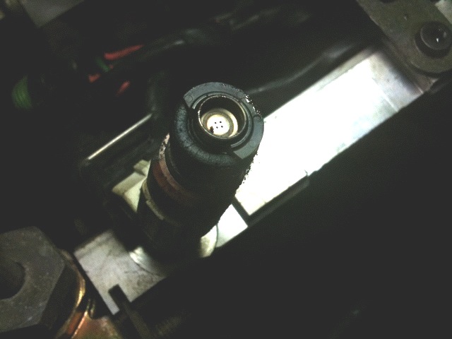

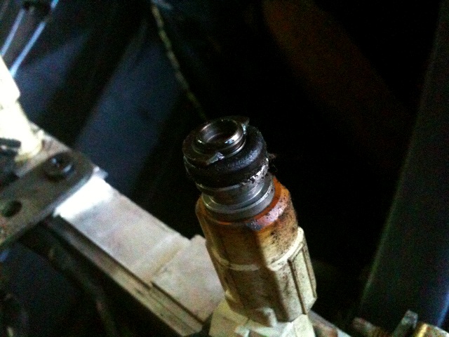

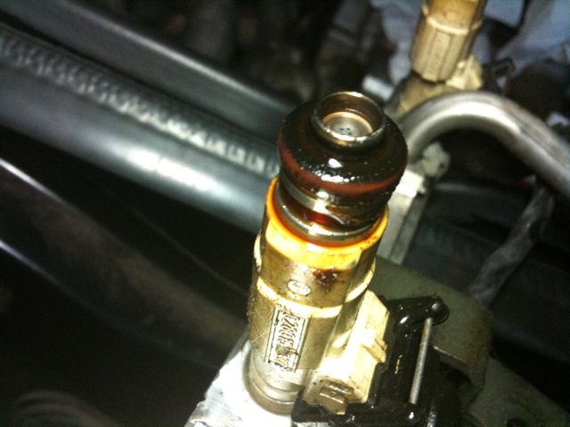

    i ask because i recently yanked my injectors to be sent off to FIC for a cleaning, and it looks like some of the old gasket pieces broke off and fell into the injector holes. could i just get a vacuum hose extension piece to suck up the broken injector gasket material? or would i need to go ahead and remove the LIM and replace it with new metal gaskets? merlot says no need to, but i thought i would ask everyone here as well.

        Those are plastic pieces... If it were me I'd be paranoid and probably tear it apart..
          I sucked the rubber grommet that goes on a 3400 upper intake where the PVC line enters the neck... I started the car with that line out and the grommet was there and blam it was gone.... never found it and when I pulled the motor apart there were no signs of it... Plastic is a bit harder but the pieces are smaller so I doubt it would cause an issue if that whole grommet I sucked through didn't make it skip a beat.
          Either way Metal 3500 lower intake gaskets I think yes you could reuse them. And just because your uppers are metal, does NOT mean the lowers are. look between the intake and the head IIRC you can tell a difference in the sides of the plastic vs the one that has the molded rubber around the metal frame.
