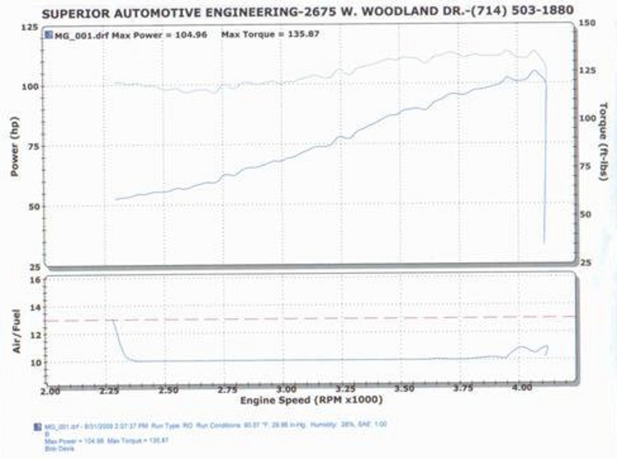

    HERE IS A COPY OF MY RESULT-

        AFR=10? Seems more that a bit rich. I'd be shooting for closer to 12.8 to 13.
          10:1 is fine.............. for a non-intercooled, 12:1 compression roots blown motor....
          i tune mine with a 12.5:1 AFR to get it all right, then lean it out slowly until it wants to knock...
          the combination of spark/AFR that nets you the most torque is less than 5% away from where knock starts
          generally speaking. your mileage may vary....
