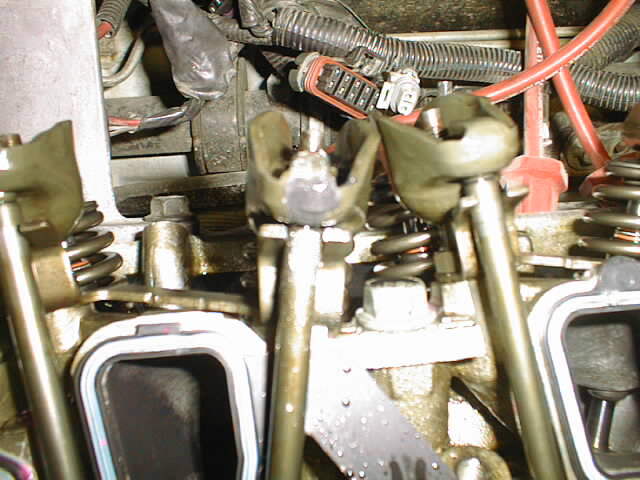

            Can you send any pics of what you are seeing, as well as pics of the engine itself?
            I was the first to discover this problem several years ago, so I have first hand experience....
              That is exactly what my intake looks like. It appears to have plenty of meat so I will try to grind itand hope for the best.

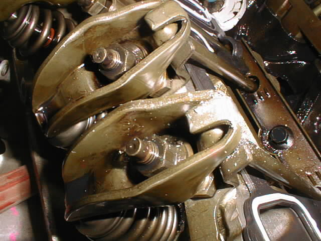

                If it looks that bad, then be prepared to do some major cleaning, as you will have metal shavings all around the rockers and possibly in the engine. I ended up dumping several quarts of oil in and around every crevice of the engine with the oil pan drain plug removed trying to get all the metal particulate out. If you don't, then you'll just be replacing the new motor very soon.
                  The engine never started, I only rolled it over a few times and when it popped back threw the intake I quit and tore the intake back off of it to investigate the push rods and that is when I discovered the intake.
                    I never got mine started either... let me dig up the pick of the rockers...
                      Mine doesn't look that bad. it had a little shavings but not like that.
