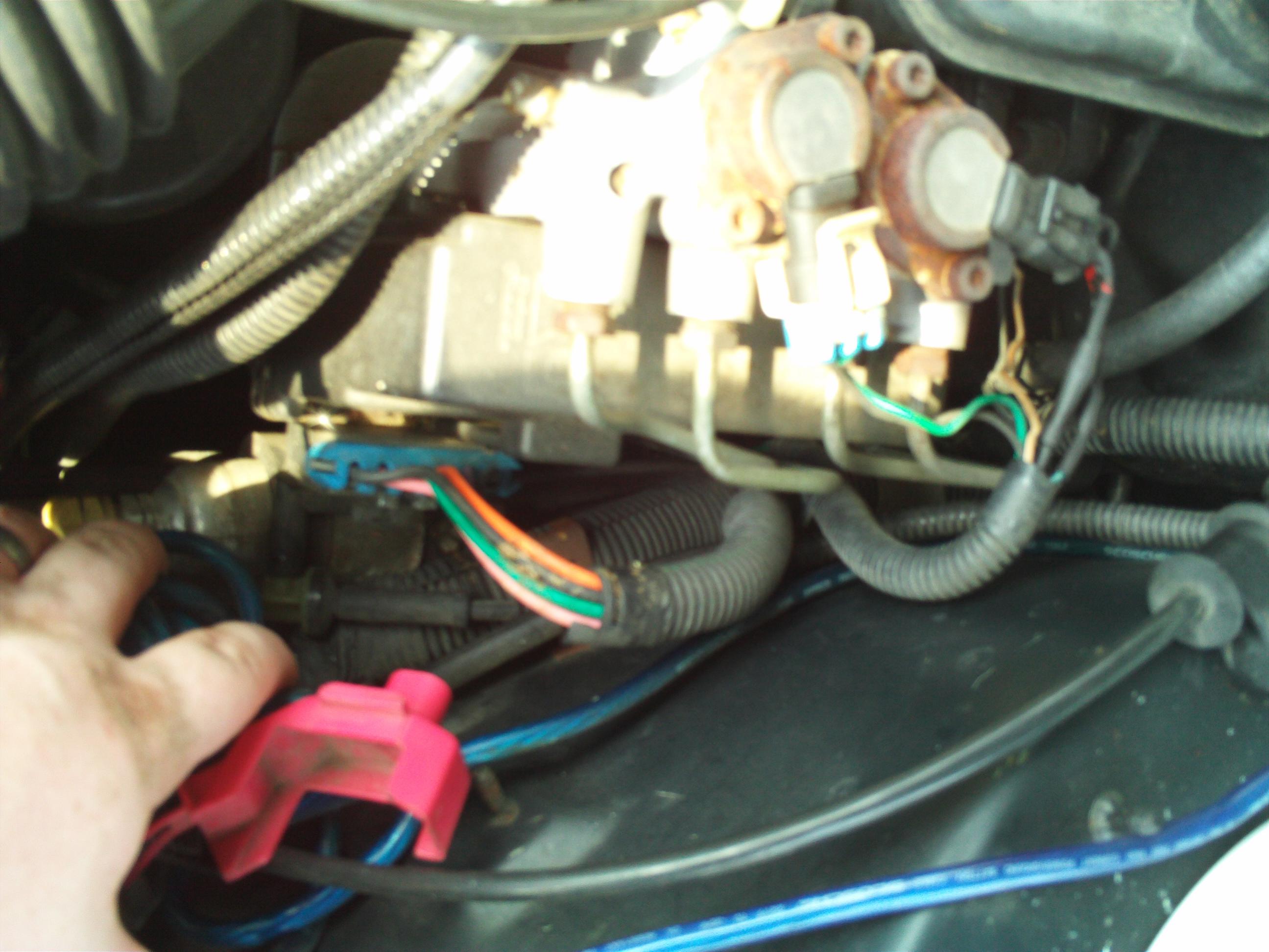

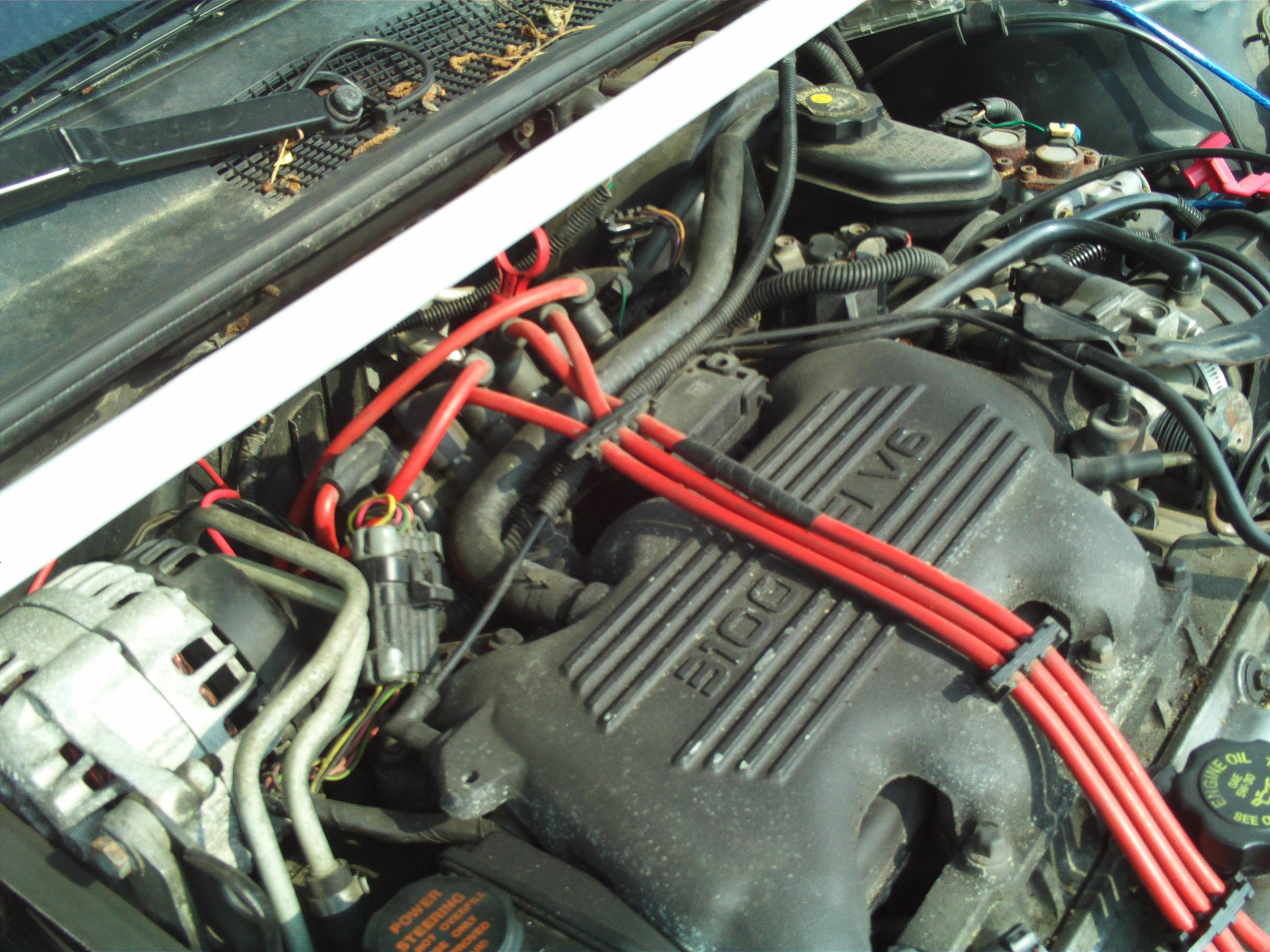

    I'm trying to get my motor back together after fixing a leaky LIM gasket, and I'm having trouble remember what went where exactly, and how things were routed. This nipple on the Upper Intake... which vacuum hose went on to it? I'm not seeing any disconnected hoses anywhere so I can't figure out what I'm missing.

    On my old engine, that was just a spare vacuum port that was capped off.
      Mine was never capped off, so I'm pretty sure something had to have gone there.
      1995 Monte Carlo LS
        i just took these pics and accoring the the emissions sticker, its for some type of accesory
        that L shaped piece right above my index finger? thats where it ends up...
          It's extra from the factory. On my car aftermarket cruise was attached to it.
          I later took the cruise off capped it, and connected the cruise to the PROPER spot up by the window wiper motor that had a factory T capped off, which goes to the vacuum canister, and now the cruise works as intended instead of not pulling anymore when the throttle opens... LOL
            Oh ok, that's the hose that draws vacuum for the HVAC controls if I'm not mistaken. The "L" piece has disappeared, so I'll just have to cap it for now.

                I meant just in the interest of getting my car running I'd cap it off temporarily. I had a bunch of spare vacuum caps laying around the basement. But actually vent controls haven't been working for a while now since that vac line had a break in it for several years now.
