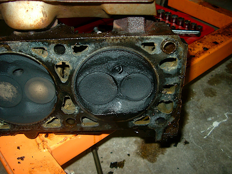

                Top end removed, valve train appears normal. Coagulated oil forming thickly over the inside of rear valve cover. I next hope I have no worse than a blown head gasket. Pressure seems to be going through the crankcase.
                Tearing down to block. I purchased a car to get me by while I rebuild the top end and further inspection.
                I am back
                Mechanical/Service Technican
                  The rear cylinder (Head) is cracked on the number 5 intake seat splitting into the chamber.
                  I forgot to add that it was the cylinder head, block is fine.
                  After removing the head it appears that the gasket was indeed replaced, even though when I traded it off it did not need gaskets, got it back with a few more K's and the wit that replaced them appears to have forgot how to sequence the bolts in order and a few were easy and a few were extremly hard to back out. Head is also warpped some and may have cause the bulge of the flex in number five intake valve.
                  Head and valves in the head are shot, inspection of front latter. Most likely will need a upper engine rebuild.

                    That iron head I posted above was cracked between the valves. Not sure if the burnt valve caused the crack, or the crack caused the burnt valve.
