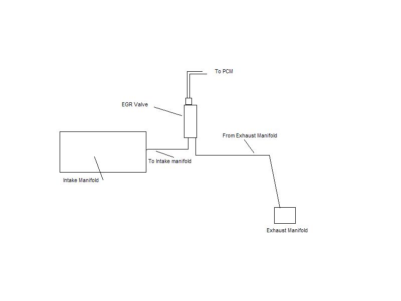

      Here's a basic schematic. There's more than one wire on the connector going to the PCM. I drew it like that just for visual reference. The PCM has total and complete control of the EGR opening.
        Ok...so it is fully electronic with only intake/exhaust ports.
        If it rains tomorrow, I'll see what I can dig up from the dealership.
        But, in the 1987 Olds Shop Manual, there are a series of steps that must be followed...to eliminate other factors.
        Can you blow air thru intake/exhaust ports via mouth (using a hose)?
        Can you hookup a suction (vacuum) to intake side and plug exhaust side, and start vehicle up and check vacuum at idle and above?
        If you have an air compressor, you could blow air thru Exhaust after putting some cleaner in it...do not try it on intake side...it might not be wise.
        If I had an electrical schematic...I might be able to say more...
