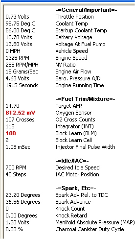

1200-1900rpm high idle, still dont know what it is
  • 1200-1900rpm high idle, still dont know what it is
    89 Chevy Celebrity 2.8L
    Vacuum at 1200rpm is 22lbs
    Can't find any vacuum leaks
    New IAC
    And this is an intermittant high idle; fixed if I unplug the battery for a minute.
    If anyone has any suggestions after looking at the attached data, I'd appreciate them.
    ~Will

          Yeah I replaced the TPS(it ran fine after for a bit, but went right back to being wierd), why is the voltage wrong or off in the picture? Throttle is closed in the pic...

                    I don't know what the steps on the IAC are after a fresh restart yet, but I bet I will find that they are way different than 40 like in the picture. So for some reason its learning to use the IAC to high idle. So I will try moving the TPS around (it is the adjustable design) first, then I will reset and record the step count on the the IAC. I'll let you know...

                        First test. Turn the key on (engine off) and jump pins A and B. This commands the IAC closed you should hear it driving. Then start the car and see if the high idle is gone. If it is then your IAC is being commanded open. If it still idles high there is something else going on.
                        Your printout does not say if you aere in open or closed loop. But if it was in closed loop your BLM is way off and it should be around 128.
                        Try those tests first and get the car in closed loop, if it can.
                          Alright I've yet to reset using the a+b method, but last week I reset by cutting power to the ecm and when I did the step count after idle re-learn mode had finished up was 16, 690rpm idle. BUT after 4 hours of driving, it kicks up the step count to 41 with the foot off the throttle. (1300-1800rpm)
                          I'll try the a+b reset method as soon as I can and post here... and yes the ecm goes into closed loop. (quickly too)
                            Was that printout done in closed loop?
                              Yes that printout was during closed loop. And I just tried that a+b reset and the idle still raises up. The idle will quickly but gradually climb up to like 1800 rpm. I think the IAC is learning to be commanded open. Especially since the step count at ecm reset is only 16, but 4 hours later is 41.
