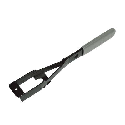

    Got a pic? Something like that might be nice for the guys running a cam and stock pushrods because they didn't know to check it before hand.
      Here's an image from Matco, listed as a "Pushrod Remover":
      The tool fits over the rocker arm and allows you to compress the valve spring using the rocker so you can remove the pushrod. I used this on a 3400 in a '00 Montana, so I believe that means she'll work on every stock 60* application (clearance between the motor and the cowl on a Montana is close).

                  Yeah, after the pushrod is out, there's no load on the rocker, and the valve is held full-closed by the spring. Like I said, this completely elimnates having to torque the rockers during re-installation, and because the rockers are still in their locks, there is no way you could accidently re-install the wrong pushrod to the rocker. I did have two that were tight going in, but 1/4 turn of the crank to lower the lifter a bit solved that issue.
                  Here's some pics of how it works, for anyone curious:
                  This is the installed pushrod / rocker setup:
                  This is how the tool sits on the rocker arm:
                  This is with the tool using the rocker to compress the spring to allow clearance for removing the pushrod (not the greatest shot, it's hard to get enough leverage with one hand when the motor is on an engine stand and wants to move also, and you've got your other hand holding a camera ):
                  This is the pushrod removed, I slid a feeler gauge under the rocker just to show the rocker tilted all the way forward:
