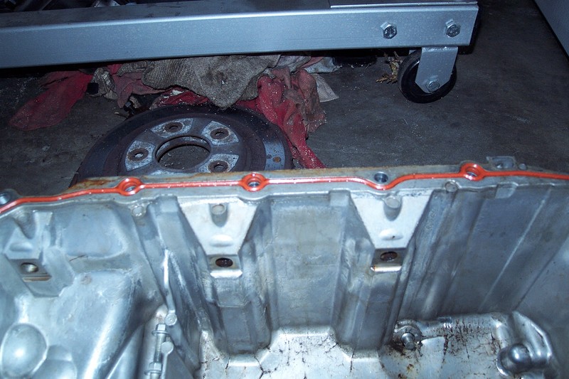

                    Yes, the 3500 block is notched in several areas to clear the crank. I can get pics tomorrow...

                              I had pics... But the drive that had them all crashed a month or so ago. Maybe I can take some tonight when the wife gets home from the movies. Don't really feel like leaving the 3mo old upstairs by herself...
                              • #45
                                Bottom of the block and the oil pan. If you need more pics let me know.
