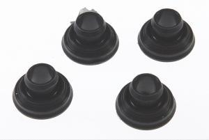

      How do you get the bolt/rubber plug out of the valve covers? Again, I don't want to break anything, so I'm trying to be easy, but I can't get them out!
      They are firmly pressed in place with hand/finger force. Takes about the same level of effort to remove. Popping the bolt out then inserting the bolt from the underside and 'popping' the bolt into the grommet usually releases them. Be sure to wipe clean the surfaces (& grommet if reusing) very well prior to installation. I like to apply a thin coat of liquid thread tape to the bolts before re-installing.
      The grommets can be had either with the purchase of a complete head gasket set kit or by themselves to do one complete rocker cover at a time, unfortunately the OEM hardware only is available only with the purchase of a rocker cover. Good news is, you can still buy the covers and can buy one side at a time which will not only come preloaded with the hardware, but the grommets as well. Under 40.00 per cover if memory serves me right. I am grateful that GM did away with the torx head hardware and went to 8mm hex heads! :

      FEL-PRO Part # HS26314PT
      FEL-PRO Part # ES71044
      If they pop out easily, are torn, brittle or visually look in compromised condition I would replace them.
