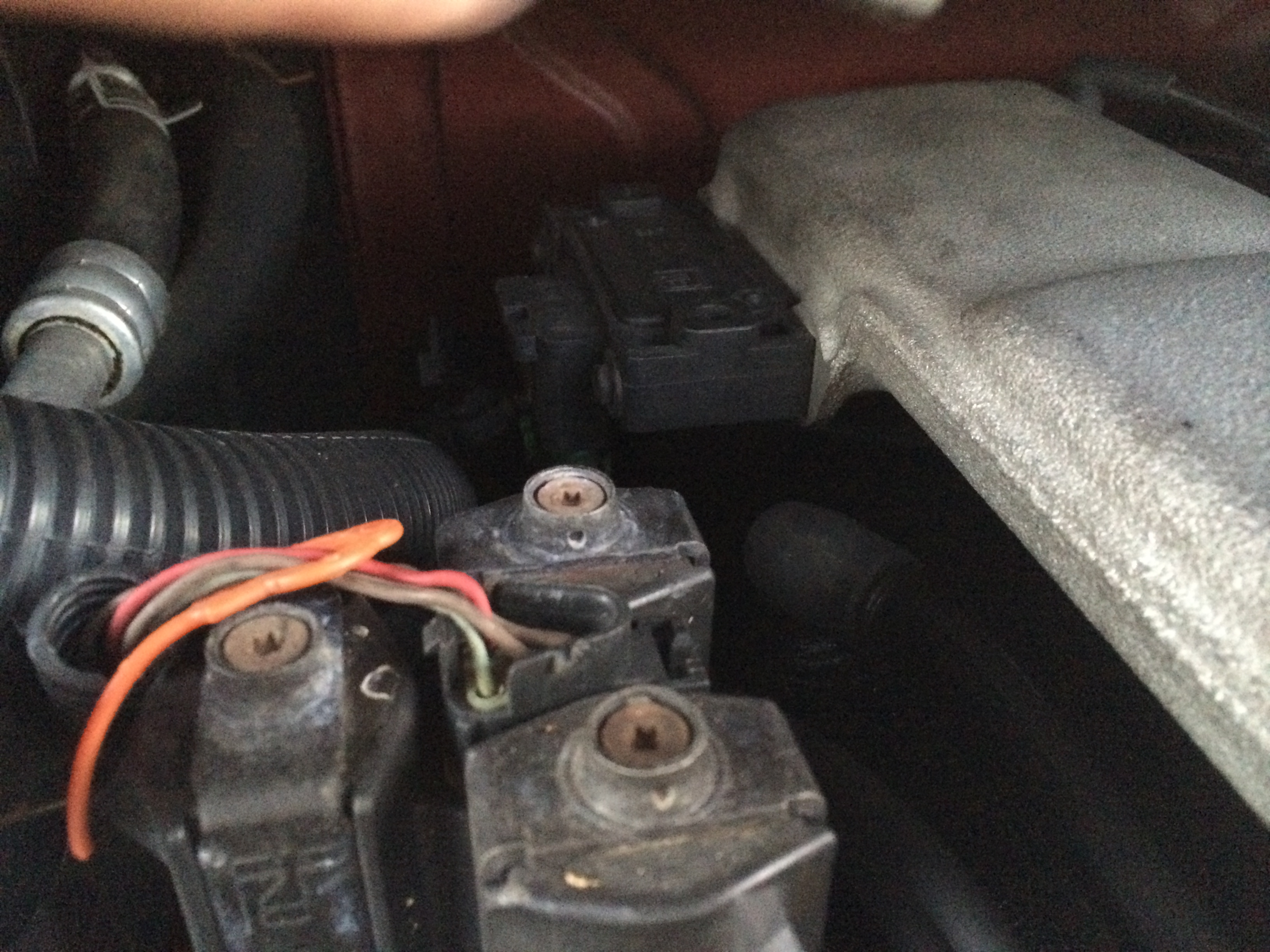

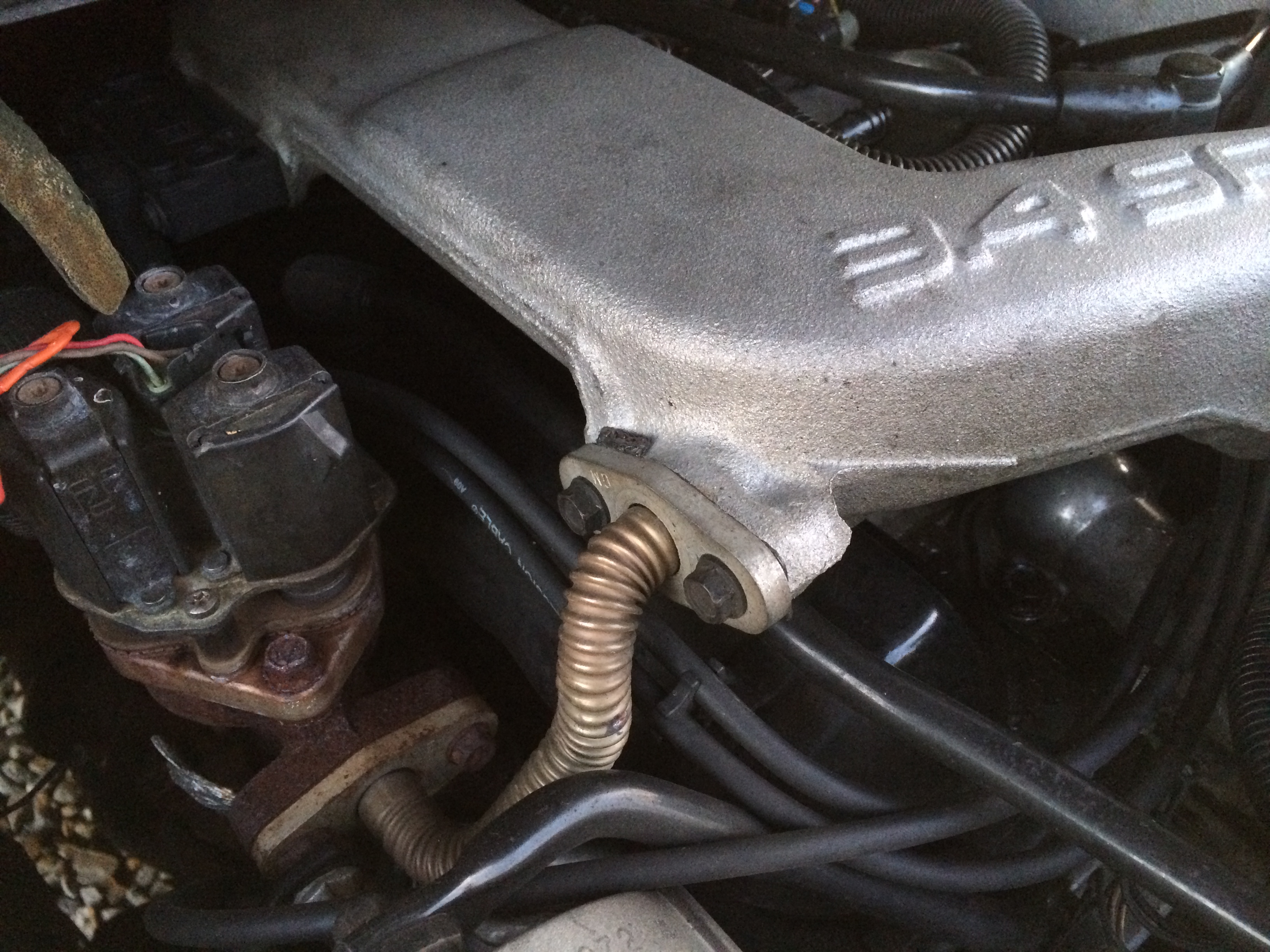

                            And Brad, (my name is Brad too, how ironic,) would the 3.4 sensors that are on the TB go onto the 3400 TB, such as IAC and TPS? I think those are on the TB. Ok, I am not that good at the sensor name game, so I'm just going to show pictures. Haha! So looking at my throttle body, all these sensors are going to fit on a 3400 Tb?

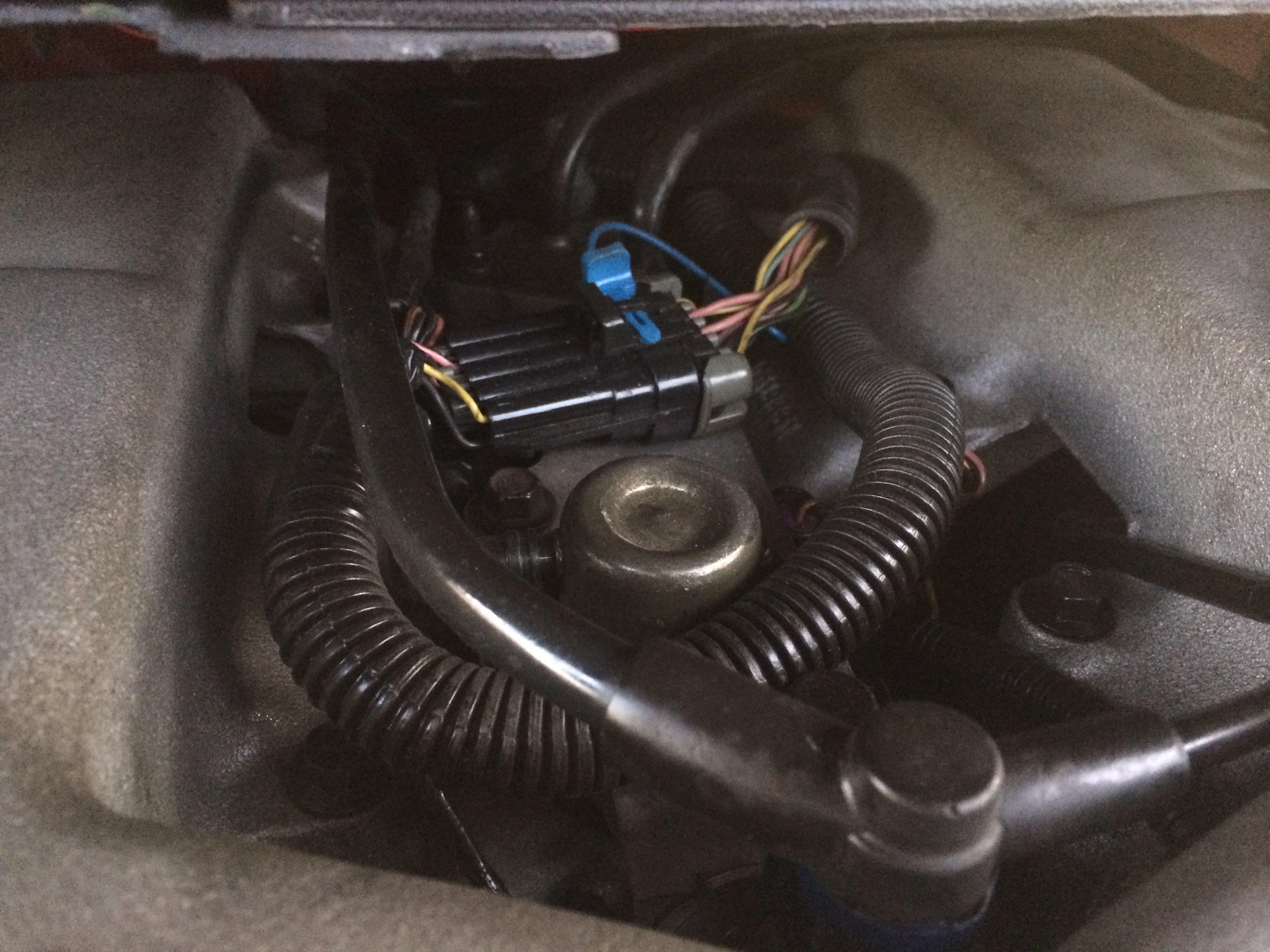

                            Now, to double check, all of these sensors that are on my 3.4 upper intake are going to fit correctly somewhere on the 3400 upper, right?

                              Yes, the TB sensors should swap over, although theres a good chance whatever TB you end up with will come with all of the sensors. GM IAC and TPS are fairly universal.
