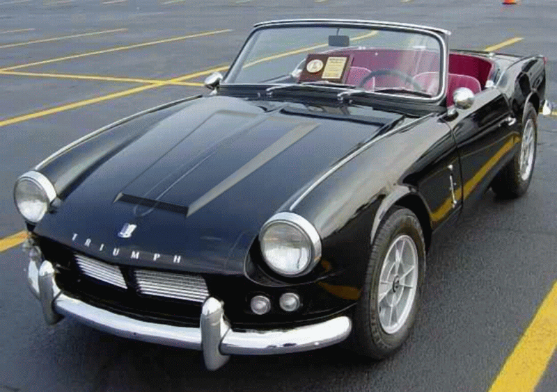

    Thanks, i was pretty close to the weight.
    Here's a bit of Photoshop magic, I added the hood scoop to a picture I found on the web, mine will be metallic silver instead of black and I'm deleting the chrome strips on the fender line front and back as well as all factory lettering and insignia.
