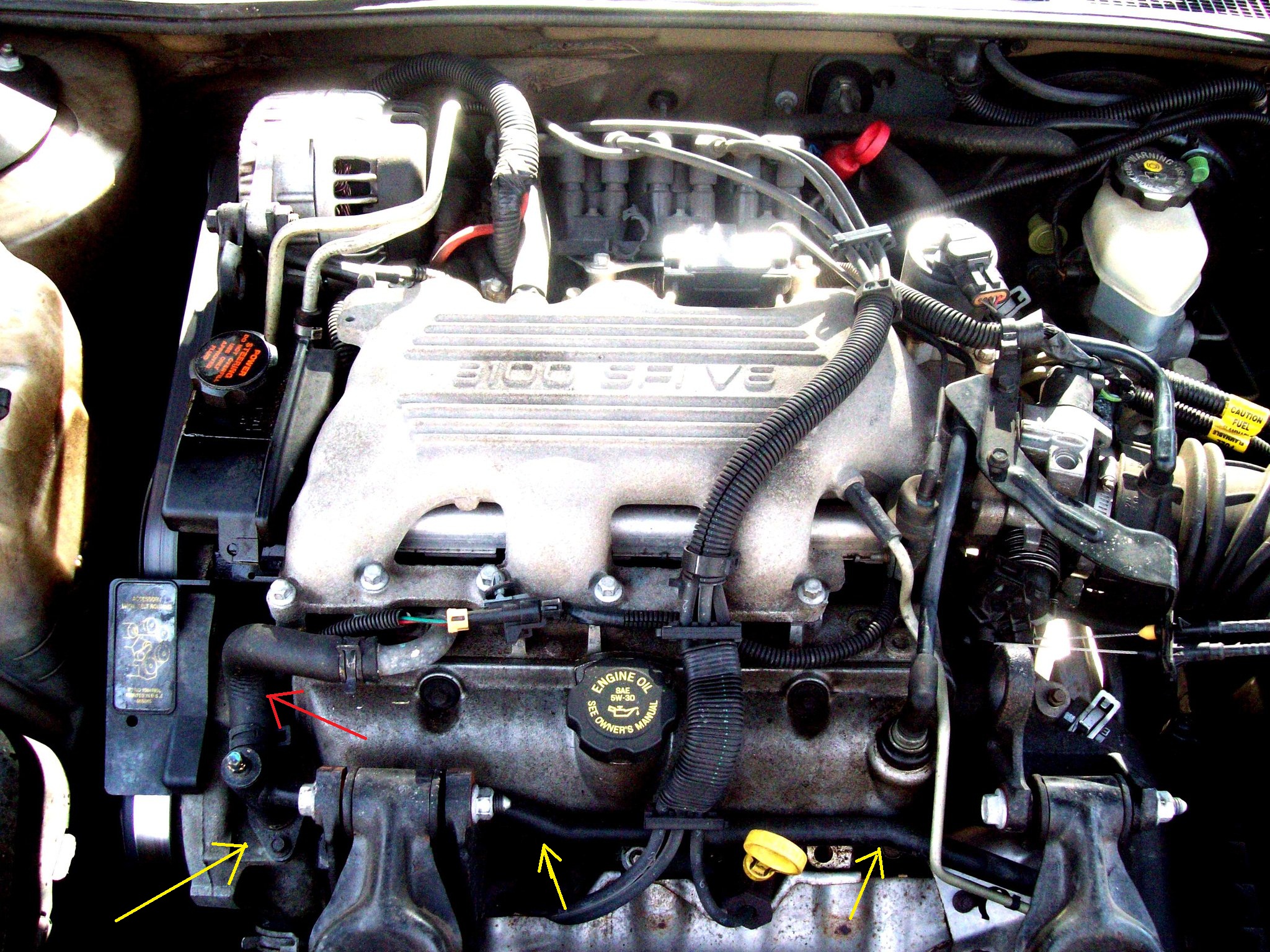

    Hey everyone, I have a 1999 Chevy Lumina with the 3100... and it has a very very small coolant leak. Normally it wouldn't bother me, but after changing the intake manifold gasket it just annoys me... anyway, I don't know the name of the replacement parts I am looking for to do the job. I attached a picture which has yellow arrows pointing to the hard coolant line that runs all the way around the right side of the engine. It's an old picture, but I suppose it really doesn't matter.

    The first leak is located where the leftmost arrow is pointing. The red arrow in the bottom left side points toward the small hose that needs replacing. The second leak is on the engine and it comes from right below that retaining clamp. I'm just wondering what these parts are called and where I can find them... hopefully at a nearby parts store. Thanks everyone!
    Oh sorry, I forgot to mention... the yellow arrows point to where the hard line runs...
      I don't know the official name on that part, but where the left most arrow is leaking is just a common o ring sealing that joint. I would take the hose with the red arrow in with you and have them look up each hose for your car to match up. I would probably do the same with that coolant tube for the o ring. Hope this helps, and welcome to the forums
        Thank you for the prompt response! I did more research and I think I found that small hose (http://www.amazon.com/ACDelco-14156S.../dp/B000C9D5AG) but I'll stop in to ask about that o-ring. Thanks for your help!
