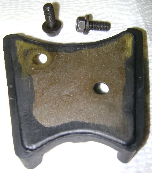

    Does anyone know what size bolts go into the block? I need to buy replacements.

      Its probably a M8x1.25 like most of the bolts on a 3x00 motor.
        i have those two bolts if you want them.
        I didn't end up using my dampner so i have the two bolts left over.
        93 Firebird 3.4

          Take Max up on his offer, because these are harder to find than Hen's Teeth and they should be at least 8.8 in hardness and Parkerized, so off-the-shelf soft steel Metric Bolts are an invitation to failure. I have dealt with Max on numerous occasions with sending and receiving parts ... tkoforpresident = A Very Trustworthy Man!
          P.S........... The bolts could use a dollop of Thread Locker (High Temp Loctite) and should be torqued down at 25 Newton-Meters ...or 18 Ft Lbs.
