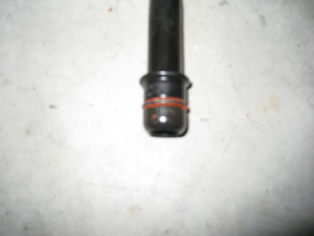

                  I have the metal tube mocked up and ready to go pretty much, I just need that oring that attaches around the pipe that goes into the LIM under the T stat to make it sealed up. Smell what I am spraying? See what I am trying to draw.

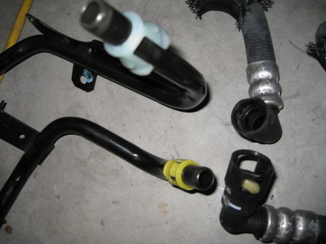

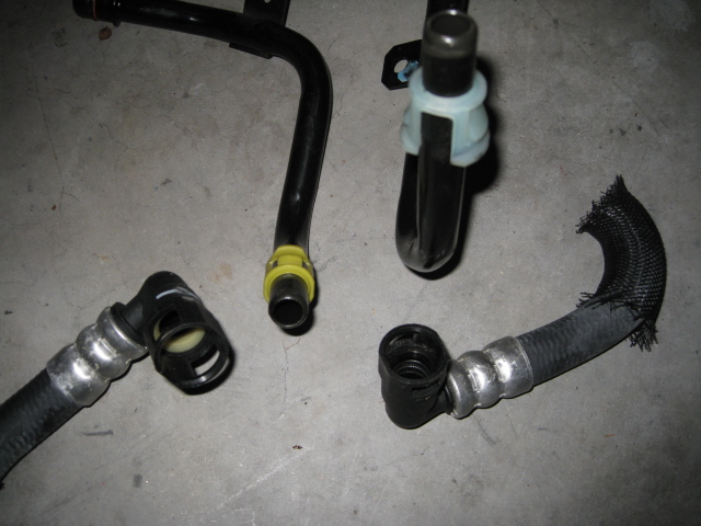

                          Here are a couple of images of the set I took off of my LX9/3500. I used my existing LA1 lines and quick disconnects.
                          I suppose that you mean the O-ring shown in the third image?

                            YeeeAp that looks like it.
                              like i said quick connect just like the 3400
