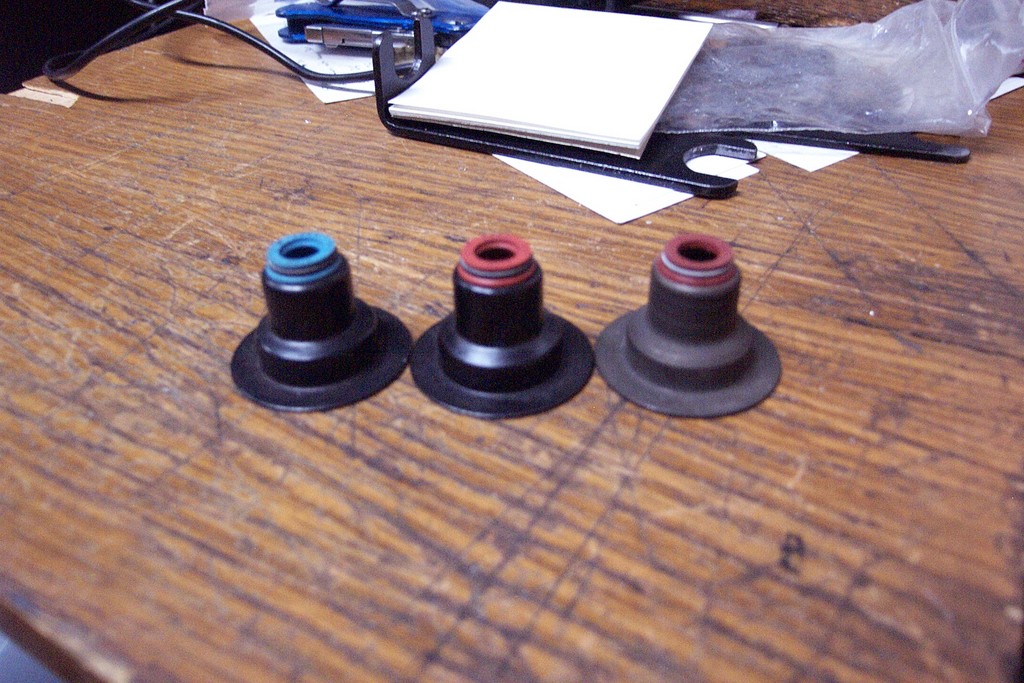

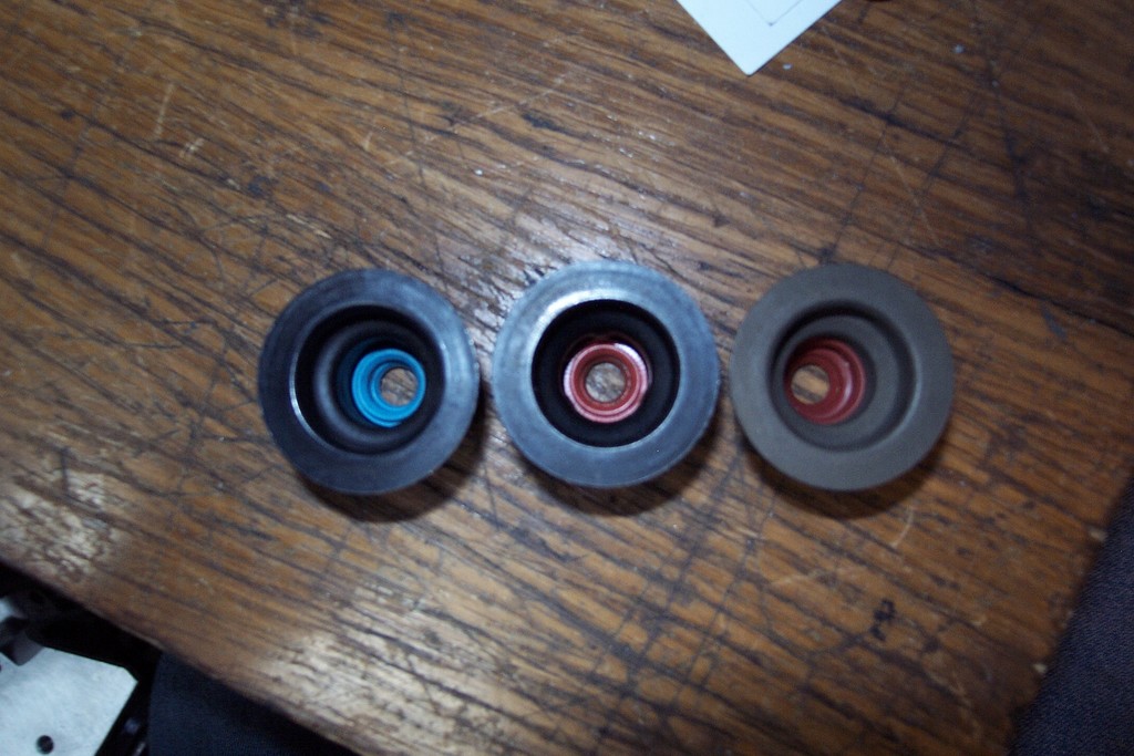

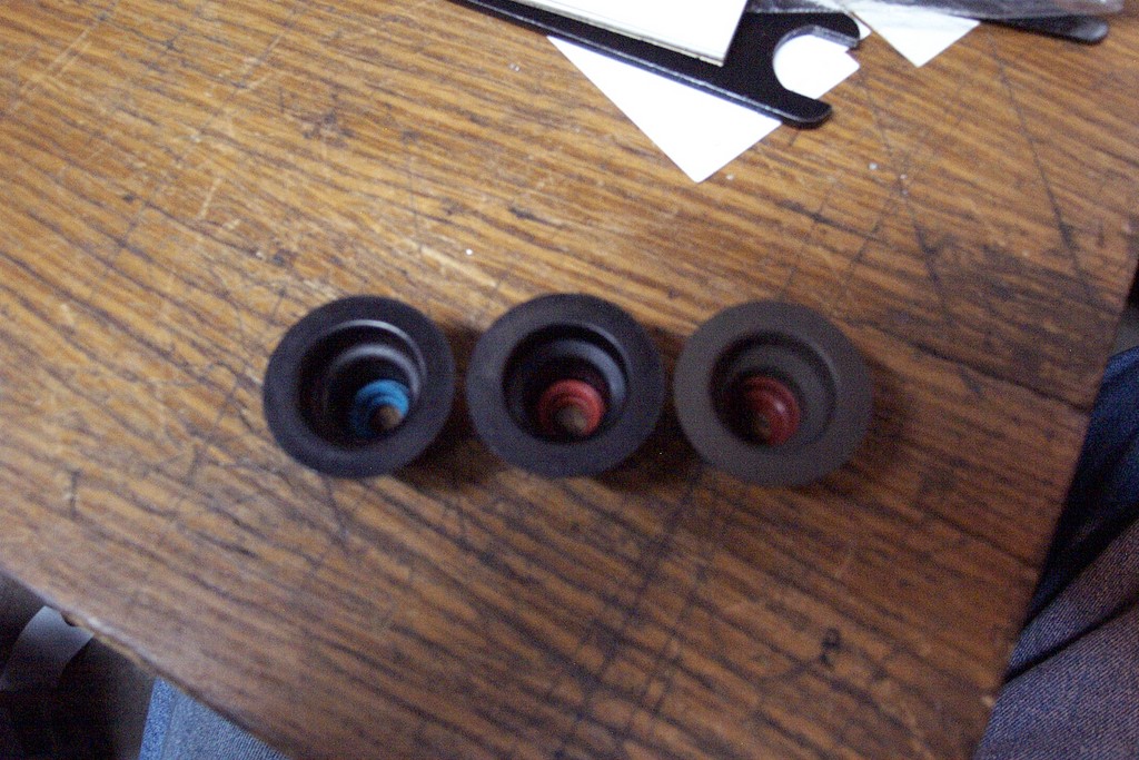

      I have 3 different valve stem seals now. the blue all have the crimp so far, but I have 2 different orange. The non crimp has the seal inside the casing vs the crimp that has the seal up on top and not so far down inside. I will take pics when I get home and post them. The machine shop is going to have some seals in tomorrow to see if they are the crimp or not.

            First pic is of the 3 versions. Left is 00+ (.553 OD guide), 94-99 .520? OD guide. 3rd is um...wrong. It fits the .553 guide no problem but if you look at the other pics, you can hopefully see what the seal itself looks like on the inside. Oh, and you can't make out the crimps in these pics
            The metal part is a dull etched looking black vs the nice gloss black of the seals that have always worked well.
