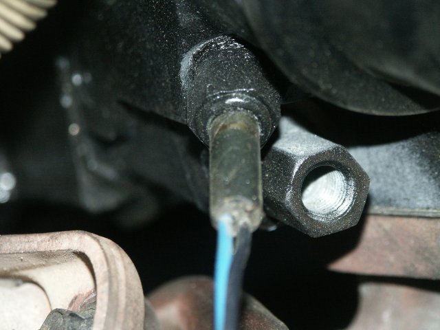

    I have a a set of heads off of a 92 Regal (3.1 ), there is a weird looking, at least to me, sensor on one of them.
    It looks like a real small CTS, but instead of the normal plug, it has a 6 inch pigtail with two wires coming out of it, a blue wire and a black wire.
    Does this ring any bells???

      I forgot to mention that the Blue and Black wires terminate in a two-pin weatherpack connector. The two wires coming out of the other side of the plug are both green w/white stripe ???
      Actually, I do not think it is a fan switch directly- the ECM controls the fan...
      I have found only two CTS units. One I know send two signals to the dash (one for the guage and one for the idiot light)
      Maybe the sending unit with the pigtail is for the ECM? The blue is the signal and the black is the ground???

            The "blue" wire should be green, probably just looks blue due to oil and heat getting at it.
            This is a dual connection CTS. I know one side is for a gauge, and I believe the other side is a switch, possibly for a light. I had one in my truck for a while and only used the black wire, as that ran my gauge, the other one never seemed to change state, whihc is why I believe it was a coolant over heat light sender. I know I have also read information that would confirm this but I don't recall where.

                  Exactly, it runs a gauge and a temp light. I've had several Celebrities with the same setup, only difference was, the sender had a pigtail with green/white and green wires to match the vehicle harness.
                  The sensor in question is likely an aftermarket replacement with different colored wires. They are known to fail, causing the temp light to gradually come on as the engine warms up.
                    The only thing I am wondering about is that the engine was a from a 92 regal, so it would have to be something aftermarket if it was the temp sensor. Every regal I have seen had the one wire. The previous owner might have added something.

                        The first one should be of the sensor in question - the blue wire is definitely blue...

                          That first one is deffinantly the coolant temp sensor for the GAUGE. I have never seen one with 2 wires before. Normal stock is 1 wire that is either GREEN, or PURPLE.
                          Hard to tell from the second pic, but I am going to guess that it is near the thermostat area? That looks like the coolant temp sensor for the ECM. which is normally 2 wires.
                          If you can get a picture of even both of them pulled further back, I can confirm this.
                          On the first pic, the sensor lookes like it is next to a head bolt, so that is how I figure it is the coolant temp sensor. I still need to get down there and take a pic of the one on my STE for you.
                          Just so you know, you can get a sensor from a 1996~ish 3100 car. It is a 3 wire one that uses a connector like the TPS. I used that one on my STE becasue my single wire one was bad. It will screw right in, and I only had to run 1 wire and solder the other 3. Might want to consider doing that. I will try to get a pic of that as well.

                            I can try to get another pic today. However. I know for certain that the second pic (the CTS with just the male plug on it) is for the gauge/idiot light.
                            I have already tested it in the oven
                            I didn't want to toss the one with the wiring pigtail in the oven, for fear of melting the insulation.

                            It looks like that due to all my mixing and matching of parts, I have two sending units that are for the same thing - i.e.: the gauge/idiot light.

                              In the Regal, the sensor on the rear head is for the gauge/idiot light, and the sensor on the lower manifold are for the ECM/cooling fans.
                              Here is a pic of the HEAD sensor in my 1990 STE. The car is all together, so I can't really get a good pic, but you can make it out. I cut the pigtail off of it seeing that I am using the 3 wire sensor that goes into the lower intake manifold.
