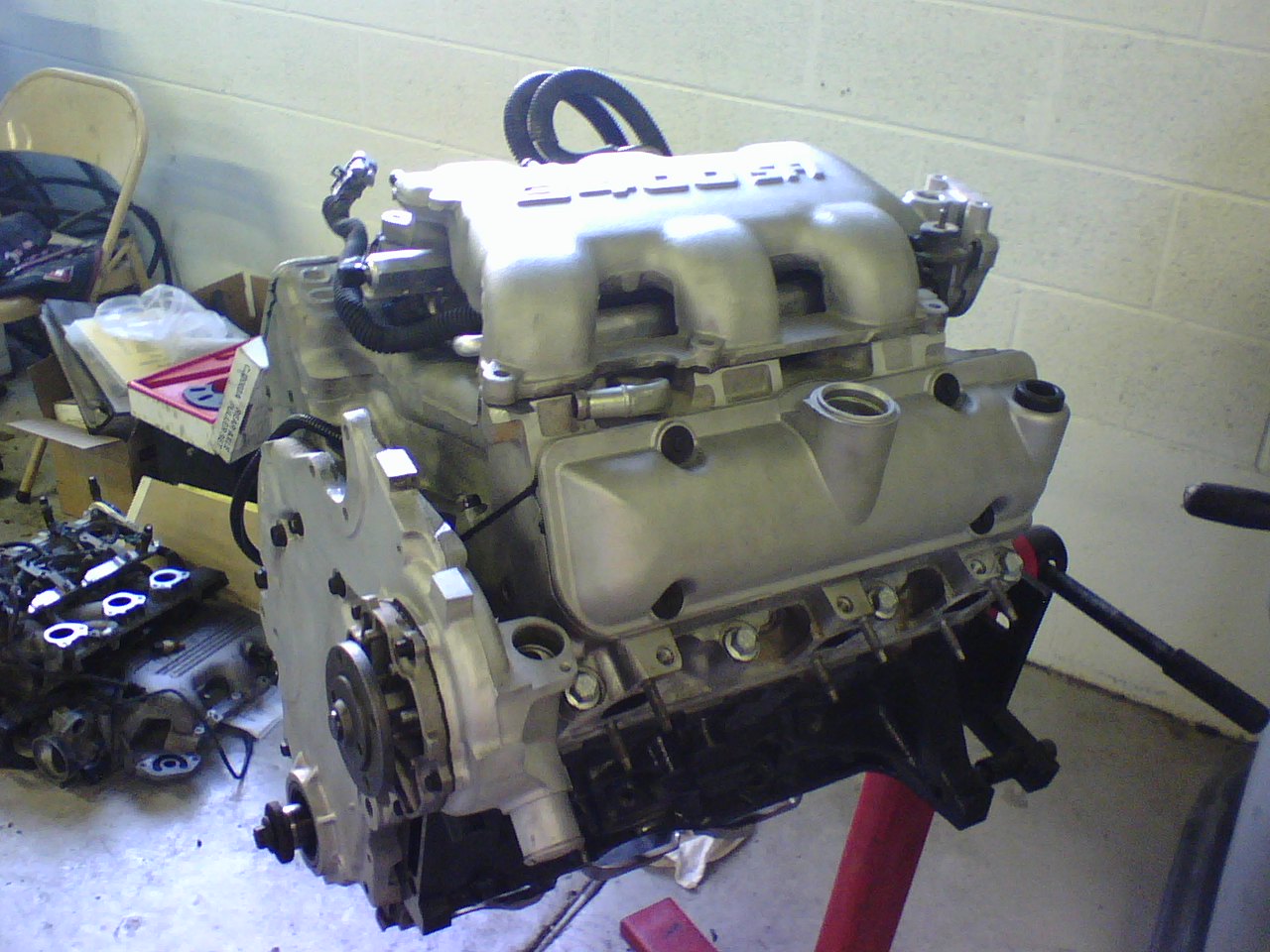

            Hey all just a little update.
            I used fel-pro permaseal gaskets for the lower intake, its universal and works with or with out pushrod guides, and it seemed like a hell of a beefy gasket(its metal with rubber inserts). I read somewhere that a 00' LIM would go on a 3100 early style with no banging into the rockers, well thats not true, unless they switch styles somewhere. Ended up heli-coiling a stud hole. Everything else seems to be coming together really smooth. Heres a updated pic:
              So the ports lined up ok? Perhaps I was smokin' crack.
              What about the EGR valve? If the wiring isn't compatible, there IS the option of making an adapter plate. It wouldn't be difficult, but would require some machining. I know that it's been done before.
              Actually, if you were ambitious and patient... and could acquire an appropriately sized chunk of steel, you might only require a drill press to make an acceptable adapter.

                I didn't think the ports would line up well either. AFAIK, the 3 solenoid egr was never used on the 3X00 motors and the later two are electronically interchangeable, so it won't be a problem.
                  So you have a 96 but DONT have the roller fulcrum rockers?? ODD! yeah you'll have to grind to clearance the LIM then. 96 should have stepper motor EGR and should be able to use the 00 stepper.
                  94-95 3100's had the 3 solenoid EGR, which you can get an adapter for either style 3400 UIM on the sore.
